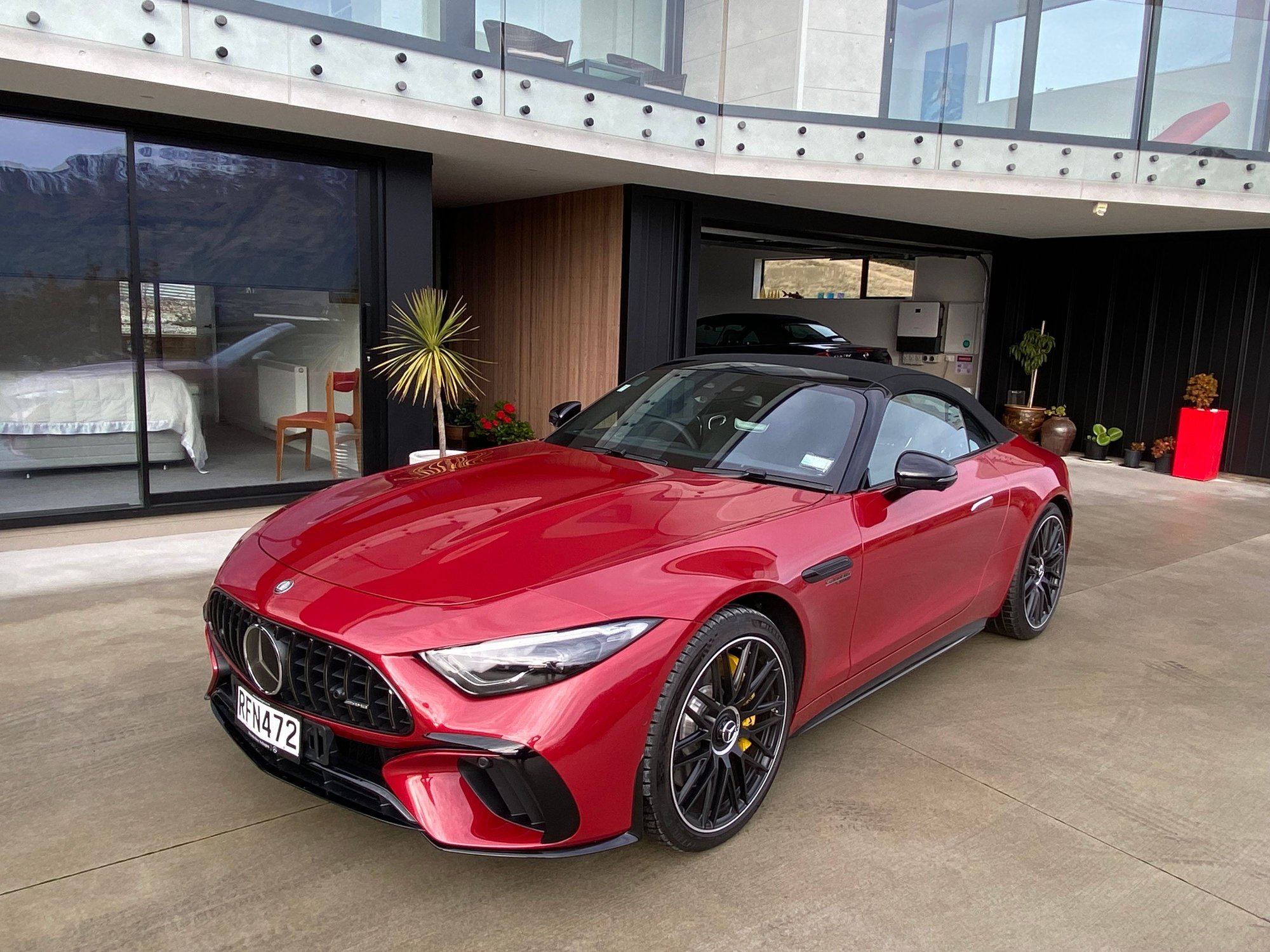

Old Aug 18, 2025 | 07:48 PM
  #266
smandkjc's Avatar
Joined: May 2004
Posts: 85
Likes: 10
From: New Zealand
2023 SL63
I ran my charger cable so it was by the windscreen wipers so I did not have to open the bonnet to remove the charger and it still told me the bonnet was open even though I had not opened it to plug in the charger.
Car giving Battery low and then Battery critical messages just two days after a 430Km drive, car now been back at the service shop longer than I have owned it.

Old Aug 18, 2025 | 11:08 PM
  #269
smandkjc's Avatar
Joined: May 2004
Posts: 85
Likes: 10
From: New Zealand
2023 SL63
I got a very very good deal on it after it had been sitting for 2 years in NZ and possibly a year in Germany!!!
Was going to order a CLE53 Cabriolet but got temped by the SL63, I just hope it will be good when it's sorted.
Old Aug 18, 2025 | 11:12 PM

Great choice. I'm sure you'll be pleased with the decision.

Beautiful car, and therein lies the problem; beauty fools us into thinking perfection is at hand.
