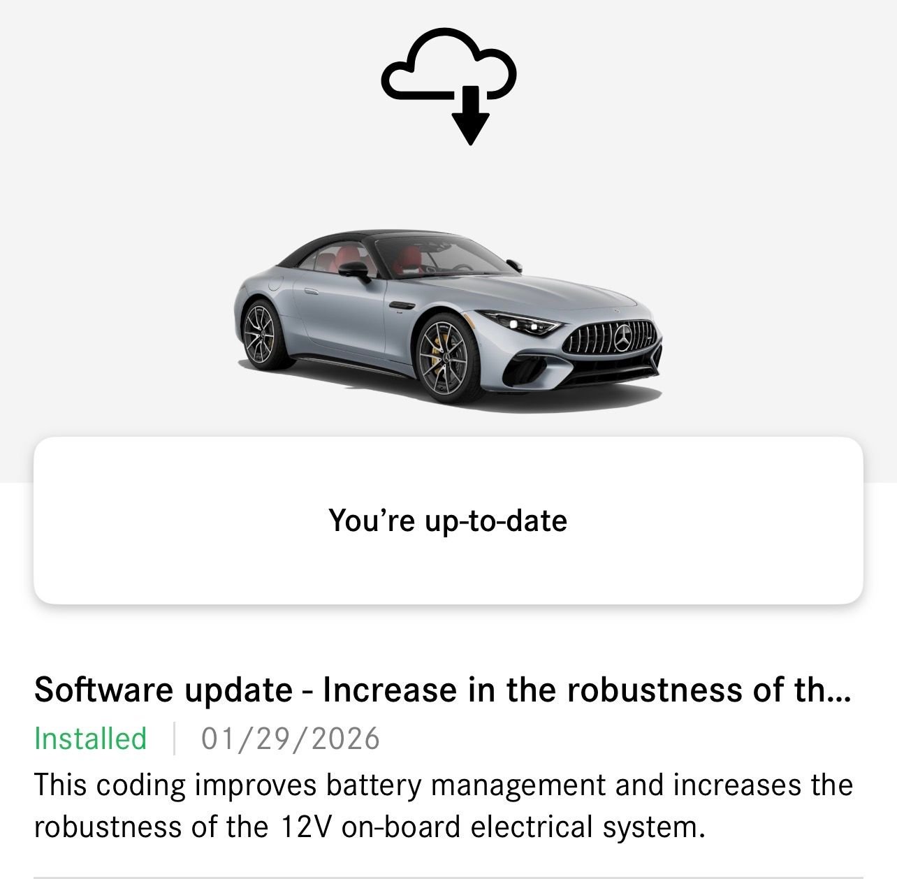

Same here. Don't know what it actually did or what the results will be.
Here’s what my MB app says about the update.
