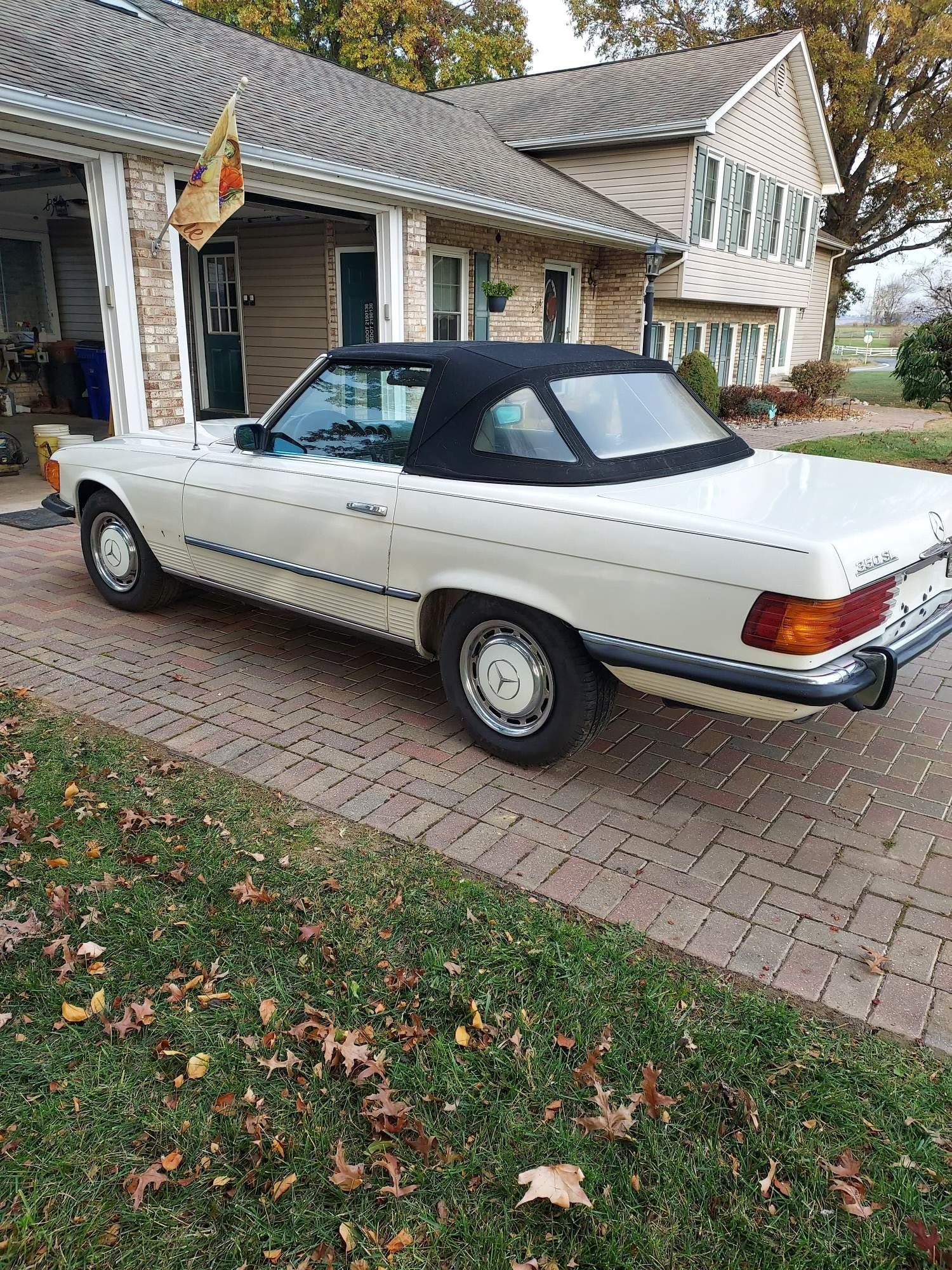

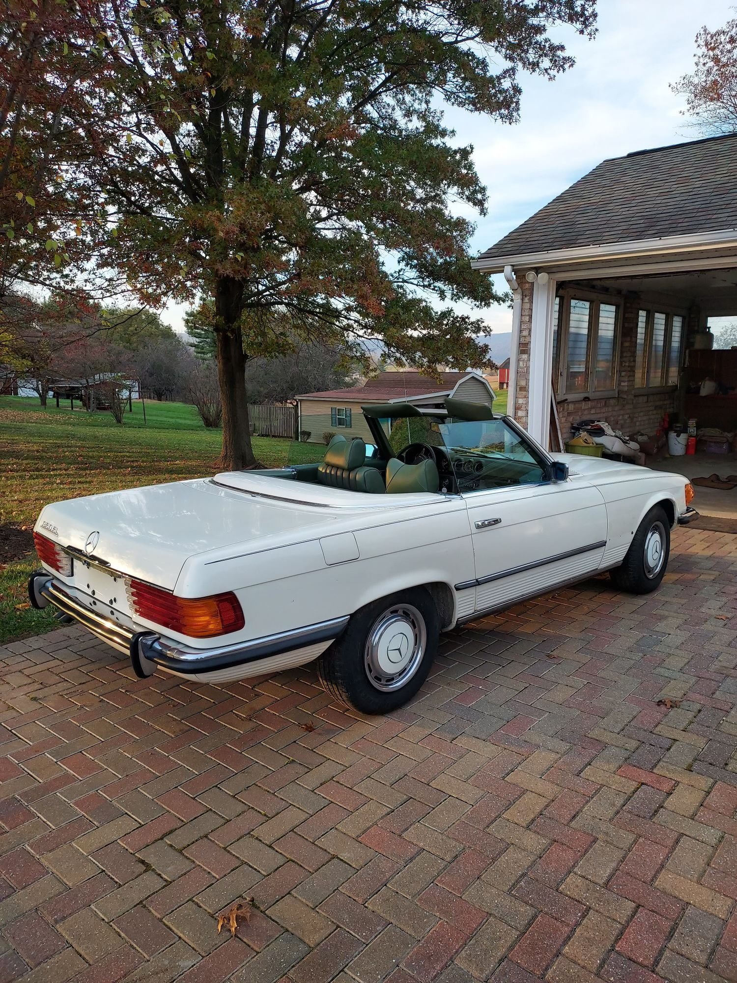

Just Purchased a ‘72
This my 6th MB, but my first “classic.” I don’t know a ton about this generation so look forward to learning. I’m curious about thoughts for an exterior paint color. While I’m not a huge fan of the 70’s green carpet, the two two dark green and maroon seats are growing on me. Exterior is white with a white hardtop and black soft top. The interior is in excellent shape - everything is as it should be with the exception of a chrome driver seat hinge cover which is easily available.
Exterior is good, no rust, but the paint has some small chips. I was thinking black or black with a very very dark hint of maroon mixed into the black paint. I don’t think the white does a great job accentuating the interior or chrome.
It’s with my Dad being garaged at the moment. Getting the fuel tank inspected as it sat for a while so thinking a tank replacement with fresh fuel and fluids is a good idea. Needs minor stuff like tires, two from mouldings reattached, and heat insulating pad which is disintegrating. Has the original Europa radio and only 44k original miles. Happy that it had power windows and AC, although absence of either wouldn’t have been a deal breaker.
would love color recommendations or any thoughts as I do refreshing while retaining the original character.

I’d leave it exactly the way it is and cut and buff the white. Once that pops your smashed avocado interior will start making sense.
putting $$$$ into a proper paint job on this does not make fiscal sense, unless you’re doing all the work to a high standard.
good looking car though, nice find.

Thanks. I’m not a fan of white unless it’s more of a pearl. And, it’s really just a project to have fun doing and enjoy what it looks like in the end. First I need to have all the mechanicals throughly reviewed - that’s the fiscal priority at the moment. Provided we are good to go there, I would just enjoy a different color. The R129 is really my preference, but this fell into my lap. Family friend divorcing and just wanted it gone. Had it not been for that and knowing they have the resources to have cared for it, I would’ve probably searched around for a different color and an R129. But, I’ve just decided it’ll be an extra and I’ll still get a R129 down the road once this one is “perfected” a bit.
Side note, we had a CLK that we loved but unfortunately my teenage daughter hydroplaned and that was done for. She was perfectly fine, the car wasn’t. We miss open air motoring.
This could be a very valuable car if it is a true 350 (3.5 liter engjne). Very rare.
​You should consider keeping it original, you could get a fantastic R129 for what you could likely get for this 107.

I definitely plan to keep it, kind of like a pet you are fostering and then can't give to another family. I haven't been able to research the VIN because of the age, at least i haven't found a resource to do that.. but I was told it was all original... i have the number plate from the drivers door, but it really just gives me the option codes like electric window lifts and Behr A/C..

Oh wow I’m just now coming around to the fact that it’s a 350 and not a 380… yes so that one you probably want to keep original to keep value.

As said before - just detail it and leave colors - it is what it is.
might want to confirm original color by finding tag under hood which shows original colors.

Yes, it is definitely a 350 and is 050 Weiss. Based on these recommendations I will think twice about getting it painted.

Ran across this post today and was interested in the source of the hard top clamp. The photo was analyzed by AI and this looks like a legitimate output:
The mechanism attaching to the hardtop in the photo appears to be a gutter-mount roof rack crossbar and clamp system from Thule, a Swedish manufacturer known for vehicle roof racks and accessories. These components are commonly repurposed for Mercedes SL hardtop removal setups, where the crossbar spans the width of the hardtop, clamps secure to the drip rails (edges) via adjustable feet with tightening knobs, and a central lift point connects to the hoist cable or hook for balanced lifting.
The name plate on the bar reads "THULE," which aligns with the partially discernible text in your uploaded image. Thule doesn't make dedicated hardtop hoists but their rack systems (e.g., models like the Thule SquareBar with gutter foot packs such as the 300 or 400 series) are frequently adapted for this purpose due to their sturdy steel or aluminum construction and compatibility with classic car profiles like the SL's."
