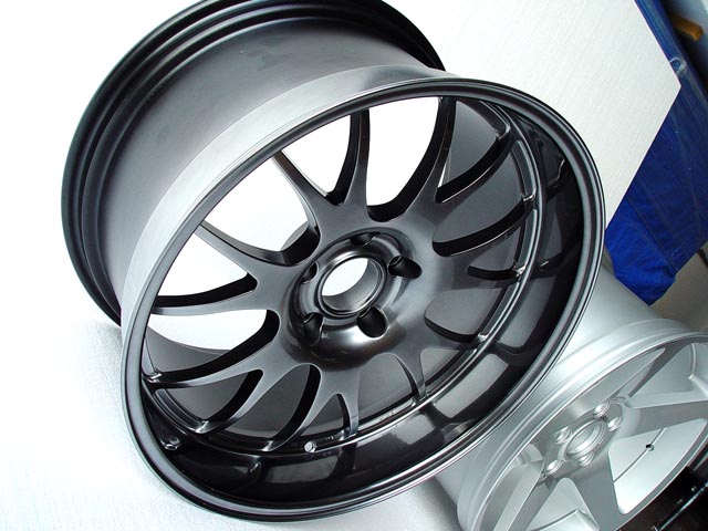

Is HRE a better forged wheel than NEEZ? From what I have read NEEZ uses an 8,000 ton forging process whick makes them the lightest, toughest wheels ever made.
Old Dec 21, 2005 | 09:05 AM
D2-AUTOSPORT's Avatar
Former Vendor of MBWorld
Joined: Jul 2004
Posts: 1,627
From: PLAINVIEW, NY
VIPER
NEEZ Wheels are constructed utlizing magnesium, thus they are very light and very strong. Once again, I do not think the key driver is better vs. worse as much as it is the proper product for the end user. NEEZ wheels have a very sporty and aggressive aesthetic to them and perhaps some may prefer the HRE or MODULARE look for their wheels.
If you need anymore info or a price quote on NEEZ wheels, please feel free to contact me. EMAIL LINK

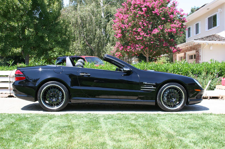

I put HRE 540R Wheels with 295/30-19 rear tires and 255/35-19 front tires. I am very happy with the ride and look.
https://mbworld.org/forums/attachmen...id=57899&stc=1
https://mbworld.org/forums/attachmen...id=57900&stc=1
Hey CUE, your car looks sharp with the 19's... I have two questions for you:
1. How wide are the front and rear wheels?
2. Is your car lowered?
Thanks for the input
Old Jan 4, 2006 | 12:25 AM
cue's Avatar
cue
Joined: Nov 2004
Posts: 13
From: Los Altos, CA
04 SL55
Here are the tire/wheel specs -
Michelin Pilot Sport PS2
255/35-19
295/30-19
HRE 540R
19x9
19x10.5
The car is not lowered. I also put the Lorinser rear spoiler which looks awesome!
