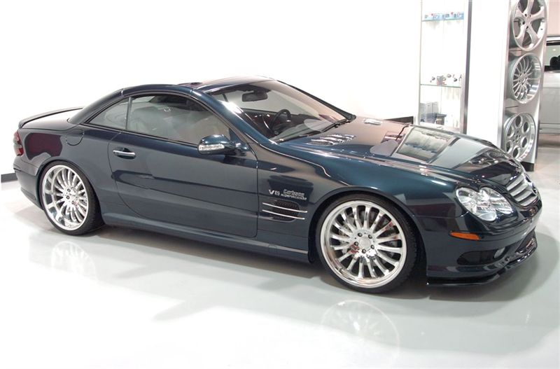

When I got my SL55 last year I researched this and wound up with the top of the line Carlsson wheels 20" and Michelin Sport tires. The ride loss is negligible and the look is awesome. If you ever try to sell your new wheels 20" are far easier to sell than !9" I test drove another SL55 that had 20" wheels before I made the purchase and am very happy I didn't go with 19"

When I got my SL55 last year I researched this and wound up with the top of the line Carlsson wheels 20" and Michelin Sport tires. The ride loss is negligible and the look is awesome. I test drove another SL55 that had 20" wheels before I made the purchase and am very happy I didn't go with 19"
Attached Thumbnails SL55 - Tire and wheel size options....-badge.jpg   SL55 - Tire and wheel size options....-dsc_6399a.jpg   SL55 - Tire and wheel size options....-dsc_6401.jpg   SL55 - Tire and wheel size options....-dsc_6409.jpg

Great pics, clay
Your car looks like mine only mine is black. My rims are not staggered. I followed the advice of Claude at Carlsson. He assured me I wouldn't have a problem with the 20's and I haven't.When I travel I carry the old lugs and masking tape just in case but so far so good. The only down side of 20's over 19's that I can tell is if you have a flat. Fixing 20's will be a lot more expensive I would guess. Claude was the most help of anyone I talked to and I talked to quite a few people. They all tried to sell me something. Big surprise,huh.

Yeah, I did like 8 options on that car, even the stinkin' badges ("baches? We don't need no stinkin' baches!" LOL). I was worried about going to 20's -- no problems though. Fix-a-Flat, PS2's, and good ol' MB Roadside Assistance take car of the rest.... I never get any flats, though....
(I have changed-out to silver 1-16's since those pics were taken...just too much chrome for me! But, damn, she sure looked good with 'em! That was my first MBZ in Black Opal).
