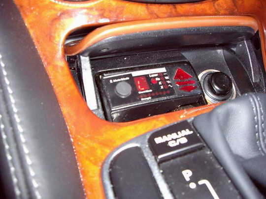

Here's a picture of my remote display

Nice installation. Nice load of dust also. Looks like you coughed up a powdered donut.

good guess
