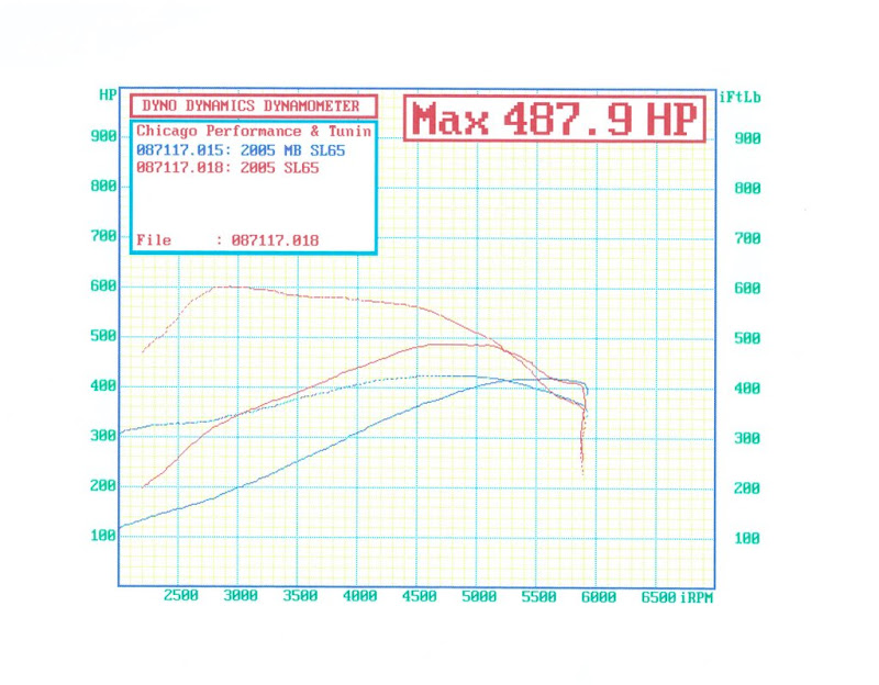

What a difference a good tech makes.
For the past year I have been struggling with lowend power on my 65. It was the absolute strangest thing I've ever seen. Below 4500rpm my car was a pooch. We tried a bunch of different remedies - water pump, heat exchanger, boost leaks, etc., etc., - nothing helped.
I did a before/after dyno with the new heat exchanger and CM30 pump, no gain in power (will post dyno if people are interested). Pictures of the heat exchanger installed also to follow... crappy phone pic for now.
I then began discussing the more "in depth" possibilities that remained and the potentially expensive repair bill they could carry (thank you MB Extended Care). The trouble with even having MB Extended Care is that we had to approach a low-power issue that was giving no codes - the proof was in my Dyno #s and my trap speeds (117-118). Enter nick55, a very talented V12 tech, and we formed a game plan. We were gonna target software first, since most of the mechanical stuff - barring the more in-depth stuff - we have eliminated.
Nick spent a few days going over the software in the car and found the proverbial rats nest. Old code, and even some SL600 coding in there. An update/correction of all the software... and, well, the results were staggering...
Yes, the blue was before, and the red was after. No, I did not get an ECU tune from a tuner, this was the difference between a car w/ messed up factory software, and a car with CORRECT, UPDATED factory software. We all dropped our jaws in amazement.
Driving the car afterward was crazy. Rear end going all over the place and a serious kick in the pants performance wise put a huge grin on my face. Now it's time to hit the drag strip...
The saga continues...
-m

I was going to ask about that 446.2 RWHP, that's over 26% drivetrain loss from the 604 crank hp rating!
Then I saw a couple posts ago the new dyno... I'm surprised no one asked before you posted that. The new 487.9 rating suggests just over 19% drivetrain loss assuming the 604 hp rating from MB is correct

The reason no one asked is because it is widely known that Dyno Dynamics (DD) dynos (as listed on the graphs) read much lower (about 10%) than a Dynojet. A 446rwhp on a DD is probably pushing around 495rwhp on a Dynojet.
Tom

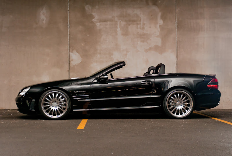

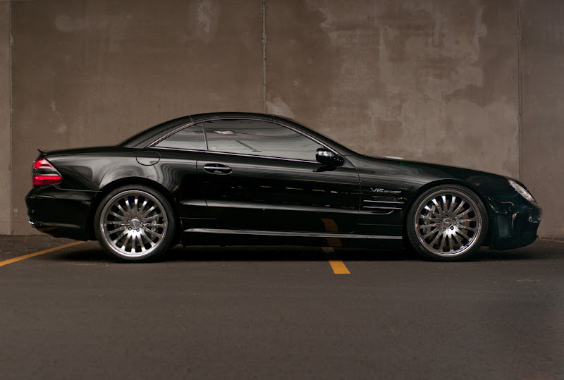

I'm being a bit premature in this unveiling but I am simply too happy with the way things turned out to hold back.
I present to you, "the impossible", the first SL65 in the world with BBS CH-Rs. We did a 20x9 and 20x10.5 setup, running 255/30/20 fronts with 305/25/20 rears (Pirelli Pzero). I would like to first thank CPT for orchestrating this endeavor, because without them this would not have happened. This required a good solid week of back and forth since BBS Germany swore these wheels wouldn't fit. CPT went to bat for me measuring and even ordering a wheel from BBS to test fit. It worked out great. I'd also like to give a shout to komp55 for the catchphrase he coined when he put BBS wheels on his E55 - "A Return To Quality"
This is my 4th set of BBS wheels and I have the absolutely highest regard and respect for them as a company. No HRE, Monarch, 360 Forged, or whoever comes close to the level at which BBS stands. I'm not saying other companies do not make quality wheels, but BBS is BBS. Half of the Formula 1 teams run BBS wheels. They are found in OEM applications around the world. They, truthfully, stand alone. I don't mean to make this sound like a BBS commercial, but I feel it's important to voice my opinion and give some context.
The bottom line is, with my Carlssons being difficult to repair (one piece forged aluminum), expensive to replace (~2500 a pop), and difficult to obtain, they proved not to be practical wheels for everyday use. They are good wheels but more suited for a lower-mileage, sunday drive type of application IMO.
We just did a small shoot on Sunday and I don't have all the edited shots yet... but I do have one edited shot along with one unedited shot for everyone to take a gander at. When the shots are done in processing they will be posted... again I couldn't be happier.
-m
