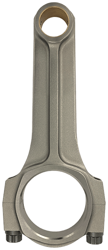

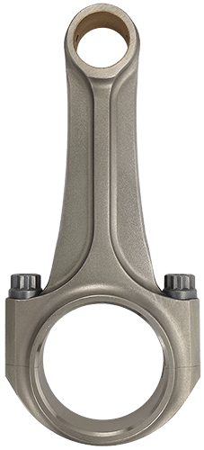

Well, it didn't take me long to decide which connecting rod to upgrade with. It's Pauter Custom made 6AL4V Titanium rods FTW!!
To compare these rods to 4340 Chrome-Moly rods, the titanium rods weigh 33% less than the 4340 counterpart. In a 6-cylinder engine, that is equal to removing the weight of 2 steel rods from the complete rotating assembly. Typically, the big end of a 4340 rod weighs more than an entire titanium rod. On a 300 HP engine, this can make a difference of 30 to 40 HP at high RPM --- plus they are stronger and more reliable!
The down side is due to the steps involved in manufacturing as well as customer demand, these rods are processed start to finish in 10-12 weeks. Oh, and at over $9K, these rods are not your tipical mod..
I was told over and over again that I didn't need to upgrade my stock rods, but that prevented me from increasing my RPM's in the event my max HP and boost is at a higher RPM than the stock 6100 RPM limit. With my increased displacement, ported S/C, top mounted intercoolers, and other mods, I'm pretty sure my peak HP and boost is at a higher RPM. I'll probably also gain another 50+ HP at 7000 RPMs if I need to rev that high.
Stay Tuned!

Interesting but did Evosport recommend these rods or you did do your own research?
I was also thinking of putting titanium rods but Vadim told me the benefits were marginal at best because MBs are relatively low reving engines without a long stroke unlike a Japanese motorcycle.
Another question I have is balance. Would the pistons also have to be titanium in order to maintain the same balance of the entire assembly?
I did my own research first and chose Pauter Custom made Titanium Rods as my first option. I asked Brad to choose out of the 5 I listed and he advised to go with Pauter, either Titanium or Forged 4340, since he currently uses them in other builds.
Our MB engines do not have a long stroke so it's easy to increase the RPM. You can't compare an auto V8 with a cycle V4, but you can compare big block V8s which have a longer stroke that keeps RPMs low with small blocks V8s that are rev happy.
No, the pistons don't need to be titanium in order to maintain balance. You can balance different materials of the same assembly.

You still have the same number of rods and same number of pistons in the same locations. Doesn't matter if the pistons are made of adamantium and the rods are made of unobtanium. You can get it balanced. Where have you seen Ti pistons?
I never have and I believe AMGSC was just thinking out loud. For the right coin I would imagine someone can make Ti pistons, but as you know, Al is lighter and it performs well enough.
Also, since my engine will be torn down to install the rods, I'll measure the piston to valve clearence again to see if there's any room for more valve lift. If so, I'll have my rocker arms made in Ti and slightly longer.
I'm trying blackbenz.. I'm trying..
