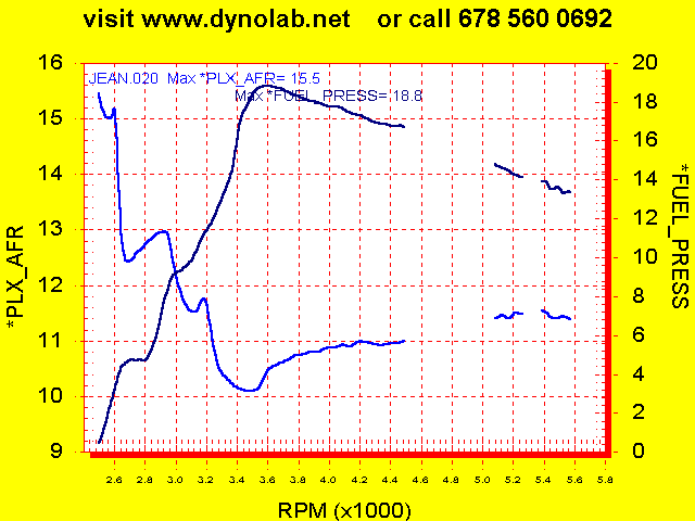

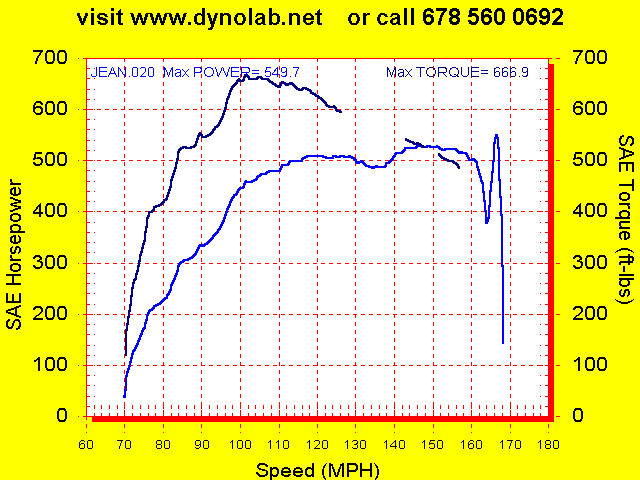

So I put 100 octane and went back to test per Marcins request. He wanted wideband, boost and torque (previous had none of that) so he can solve why this car did not make the expected 630-660 rwhp and crack 185-187 in the mile.
Notice the boost problem (Should be 23 )! Short test on Star came up clean.
NOTE: Fuel pressure feed is actaully boost.

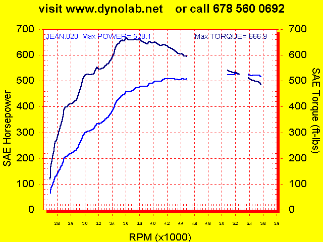

I could see the charts, you can open them up in Photoshop or MS paint. Posted below. I would send them to the tuner and have them check it out. You are short boost, could be the ECU flash or hardware. I'd try the easy route first and have the tuner re-flash your ECU and then dyno it again.
You're only seeing a max of 18.8 psi. That is an issue and I would think that tune should pull 20-22psi? The drop off could be caused by high IAT's or fueling. It shows way rich 10:1 at max boost and then leans from there. Your hp line does not dive at the upper rpm range, so to me it looks like your max boost is too low and holding down your power output. Are you running mufflers?
No mufflers, custom x exht.
Its not a fueling nor an IAT issue.
tune was set to be rich on high boost to be on the safe side. the tune has not been well tested on the 600 so 2 rich is better than 2 lean at this point.

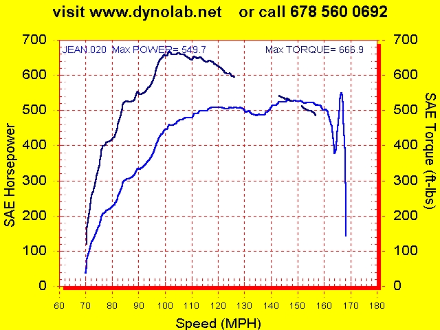

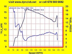

here is the other 2 graphs (550 rwhp) in jpeg.
Attached Thumbnails VRP825 SL600 DYNO, AFR, BOOST-jc-hp-tq-4th-gear-speed.jpg   VRP825 SL600 DYNO, AFR, BOOST-jc-boost-afr-4th-gear-speed.jpg
