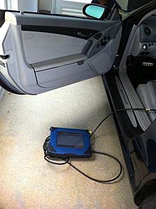

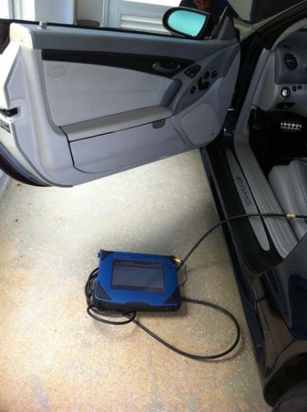

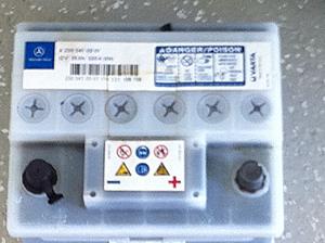

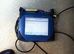

Old Oct 16, 2010 | 04:16 PM
sbenus's Avatar
Joined: Feb 2010
Posts: 160
From: San Juan, Puerto Rico
2004 SL55 AMG
problem fixed...hopefully
well we replaced both batteries today for OEM ones and then cleared the bunch of error codes that had accumulated due to low voltage.
btw, yes, this was at my garage. the MB tech is a new buddy of mine
will do a proper shakedown tomorrow
