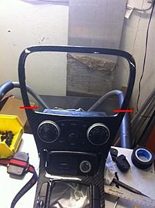

UPDATE:
Well, just like at the very beginning in my excitement I bought too much s---t. The wireless cheetah laser readout was not needed after installed so we are re working the install for a more stealth look. This and weather has caused delays. The box built for the sub that will replace the rear panel behind the seats had to be redone. The installer wasn't satisfied with the first one. Also, those who own a pre-2005 know the dash piece goes around the entire unit. BIG problem because the double din kit is fits >2005 so we are trying to mod fit the dash, i.e. cutting the top off the carbon fiber dash kit and seeing if it survives enough to look good installed. Overall I'm extremely impressed with the creativity and craftsmanship of World Wide. If they got rid of my **** retentiveness and over eagerness with equipment...my install could have been done by now

did you try contacting your carbon interior dealer to see if there would be a way to swap out your center piece for an 05? and who makes the dash kit for the 05? I have been looking a bit with minimal success.
Old Jan 26, 2011 | 11:22 AM
  #31
jmejones's Avatar
Joined: Feb 2005
Posts: 282
installer.com $94.
Looking into all options. thericker actually has a great mod on his headunit that didn't require cutting.

Slow going but more pics...
Sub installed and awaiting mesh cover.
DIN KIT getting bondo and machined lip treatment so CF dash kit lays flush on top for an OEM look. Laser jammer and built in Escort wired and stealth...pick ETA...maybe tommorrow...definitely Super Bowl Sunday....stay tuned for critique of the sound.

does that box allow you to open the rear bins? I really think I prefer giving up the 2 inches or so of the pass side floor and having the stock location, but I'm guessing this position is slightly better for sound production since it isn't under floor mat, carpet, and insulation

Yes the doors will open and yes it's better sound due to the position.

Modre pics
Custom din kit coming along

that is a very clean install

That DIN is very nicely done Coming together very well.
