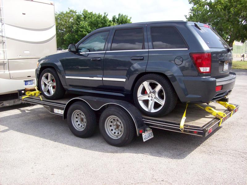

Exactly Brian! This trailer has been replaced. Thanks again.

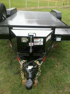

Mayhem, you have one very nice trailer and car-thanks for the pics. Do you notice much back and forth motion with that tie down system?
