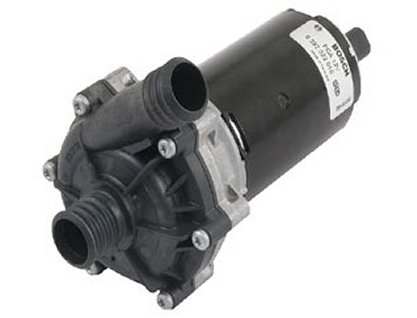

Does any one have the part number for the coolant pump for I/c for
SL65 AMG 2005. I need the MB number.

OEM #: "000 500 03 86"
Bosch #: "0392 022 010"
ZAYED,,

Thanks cm60k. Would you know how long it takes to fit on a SL65.
MB say it takes three and a half hours, 500 pounds in labour. I know it
needs bleeding, so if you have info how to fit one I would be obliged.

I believe it needs less than that, the same fitment with all 55K Engines,
ZAYED,,

Use the Bosch pump...WAY bigger, and cheaper (yes, Amazon has it). Took me about an hour and a half to do mine, including bleeding. You might have to check coolant level after a drive or two...
