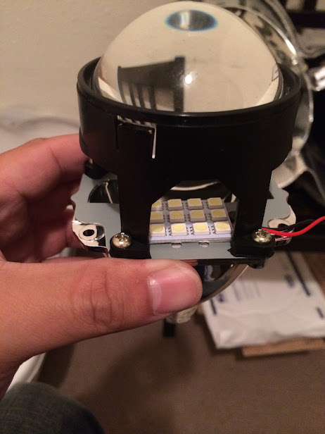

here are some details of the DRL inside the projector, it's a bright white LEDs,
and some progress pictures on the passenger side

the DRL projectors are also bright white with the 5050 SMD board that I use to replace the factory T10
