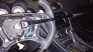

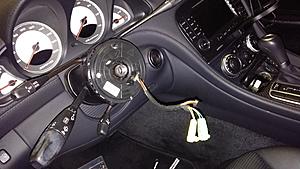

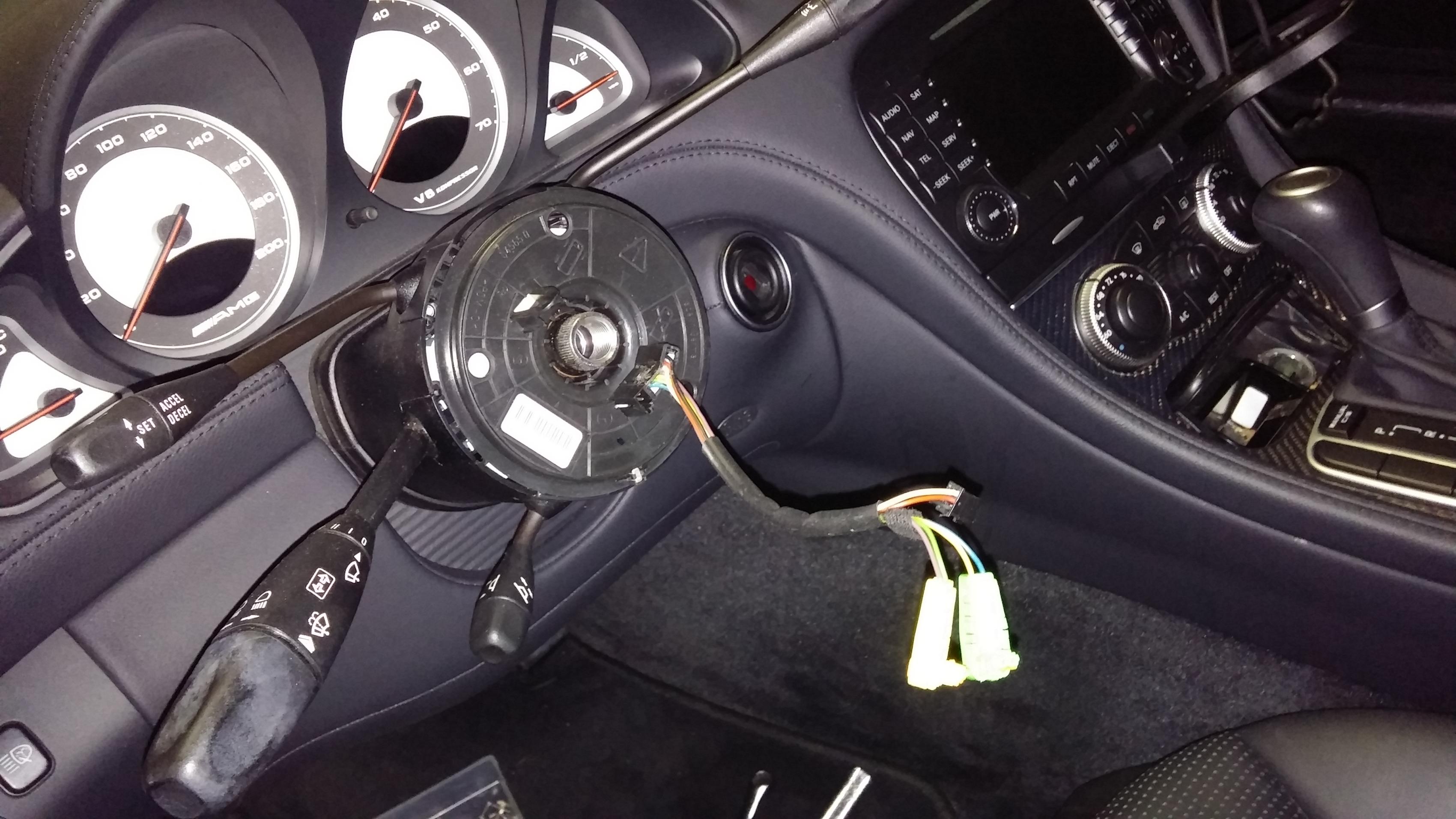

Well, carbon fiber wheel installed. Pretty simple job. Searched and found some DYI stuff regarding removal and install but, seemed all were missing something when it came to my SL (08 55). Here's what I did:
1. Disconnect both batteries (trunk and under hood)
2. Leave sit undisturbed overnight
3. Next day, remove the two allen bolts from behind the wheel and loosen airbag.
4. disconnect airbag. Here is where the DIY stuff I found not very clear. The air bag is disconnected on the backside of the airbag NOT at the wheel base (where the large allen bolt that holds the wheel in place....)
5. Use a breaker bar of some sort to break the main allen bolt free to remove the steering wheel
6. Remove the steering wheel
7. There are 1 each torx head screws that hold the shift paddles in place. Be careful here, this is a VERY cheapy plastic female end on the paddle itself and susceptible to cracking with little effort (ask me how I know.... )
8. There is a small black box inside the wheel where the 2 shift paddles connect a and a connection for the wheel control buttons? The box is easily removed with a screw driver prying back the soft rubber at each end
9. mount and connect the shift paddles to the new wheel
10. Align (there are marks on the spline and flat spots on the wheel that must line up in order for the wheel to be straight) and mount the new wheel
11. Make the connection for the steering wheel controls at the base of the wheel mounting area where the airbag wires are located
12. Connect the 3 connectors on the back of the airbag
13. Position and reattach the airbag with the two allen nuts on the back of the wheel....
[EDIT] Besides having to reset the clock and reset the auto window up/down when doors close, I did get one fault. The yellow ESP triangle lit up but a quick Google search said to turn the steering wheel lock to lock twice and that would reset the angle sensor.... It worked, no faults as of yet.
