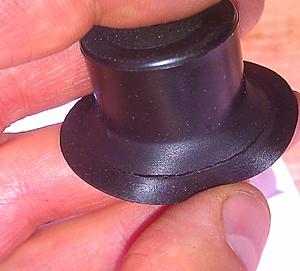

Still don't see the point of these things. There are lots of things to worry about on V12TT's, but these aren't high on the list. Its the diaphragms inside the valves that usually fail.
Speedriven BOV:  Why 6 Holes are Better Than 3-diverterdiaphragm_zps67105146.jpg
