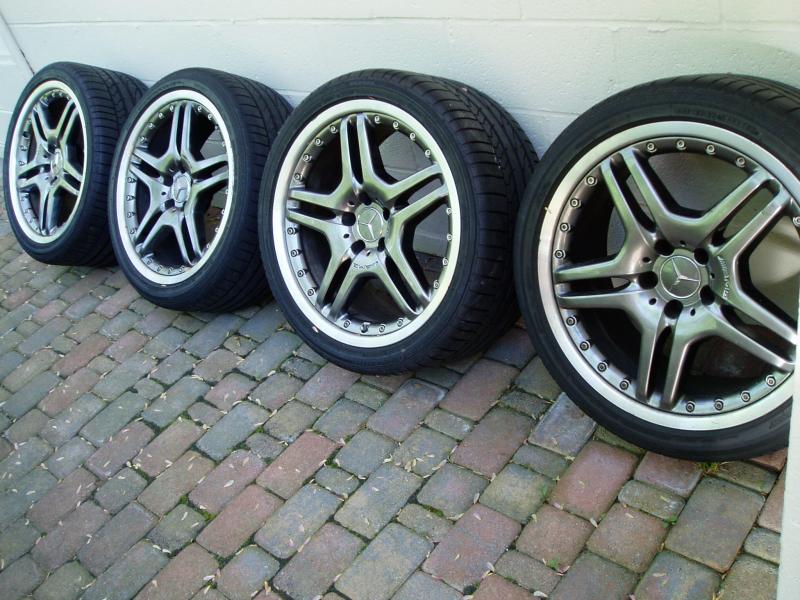

So, I am getting these new wheels and like I said, they are 19's so what are your opinion on tire sizes? I'm thinking about 245/40/19 on the front and 275/35/19 on the rear or should it be 35 on front and 40 on back?
The ones I'm replacing, front were 255/30/20 and I'm not 100% about the back but I think they may have been 255/35/20 but like I said, I'm not 100% sure.
I'm going to get Hankooks. I've had then on various cars for 12 years and I'm happy with them so I'm just stuck on size. Like I said, total newb with tire sizes.
Attaching a picture of the style of the new ones.

I already screwed up once talking about tires in this thread, but I think you would want 285s in the rear. That extra 10mm wont make that much difference, however, I currently have 295s on the rear and I swear they look a bit more meaty. If you have a drop don't go to 295s though. I get a slight rub when the car is lowered an the strut gets compressed from road conditions.
I absolutely love the wheels in the picture. If or when I change out my stockers, it would be for that look. That gun metal looks good on most cars, but seems to me would look great on my pewter metallic color.

you should use 255 35 19 front, 285 30 19 rear hankooks are good but I just bought bridgestone potenza s-04 because my first set got almost 20,000 mi and they are cheaper (tire rack)

+1 These are the stock sizes on my SL63. Agree 19" is a nice compromise. I just bent one of my OEM AMG rims but it was a significant hit that did it. I was doing 80+ mph on I79 and hit a wicked pothole. Thought it had damaged my front suspension the impact was so hard. Wheel took a bit of a beating,but considering the impact it survived ok. I've replaced with new wheels but plan on repairing and reusing the oem's at some point in future.
The wheels in the picture (and in signature) are 19" x 8.5" Front, 19" x 9.5 rear, with the tire sizes referenced above.
(Edit : for some reason picture wouldn't attach but signature line has referenced tire sizes and this link will go to a different picture https://mbworld.org/g/picture/3294518)
