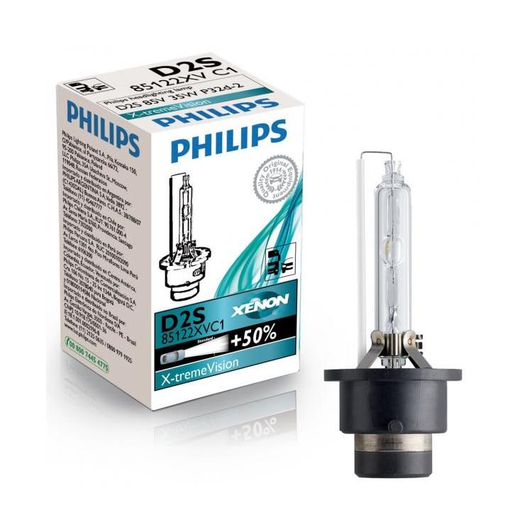

I absolutely love the philips D2s extreme. Here is a photo of the lamp (bulb). Most people recommend replacing both lamps at the same time. As the lamps start to wear, their color range (kelvin, I think) changes so you will have two different looking head lamps.
Big caveat. Before spending the money on lamps, make sure the lamp is in fact the problem and not the starter or ballast. Take the time to put the lamp from the side that works into the side that does not to make sure it is in fact the lamp.

For the HID, I took the bulb out and saw where that straight line on the side of the bulb is disconnected, I assume it is burnt out.
I haven't gone to try to take out the other side yet as I am still very new to this car, and I don't wanna go screw up the only side that works.... but I might just go try it now that you guys got me thinking. I did however noticed in the day time that the light is a bit weaker for the past few weeks or so.
When you say "straight line" are you speaking of the wire filament down the length of the bulb? If so, I agree, it is probably burned out.
Which side did you remove? I only ask because most of the time, the drivers side is easier to remove than the passenger side. The SBC unit on the passenger side makes it more difficult.
Finally, I found that after removing and replacing the bulbs a few time I became pretty proficient at the process even without being able to see well. Make sure you don't touch the glass part of the bulb with your fingers.

I haven't replaced the HIDs yet. I'm going cheap and got some really really cheap HID bulbs from amazon for like $10 bucks a pair, and gonna try my luck to see if it would work.
I know, I know, I shouldn't do that, but I thought it would be an experiment to see if the crap China made stuff would actually work and the philips ones are a truly a rip off or not. If it fails, I will go immediately get the $100 ones.

CRAP, it is the ballast that is broken I am very afraid.
I actually installed the Chinese Xenon lamps on the other side, and it works!
