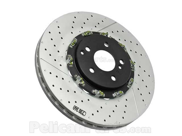

Sl55 with 8-pot calipers, uses very cheap 1-piece Rotors,
Rotor #: "221 421 18 12", (360x36)
but 6-pot calipers, comes with expensive 2-piece Rotors,
and with (3) options, depends of spec.:-
* code: "-030", Rotor #: "219 421 02 12", (360x36)
* code: "P030" Rotor #: "230 421 09 12",, (380x34)
* code: "P030/P98" Rotor #: "230 421 12 12",, (390x36)
