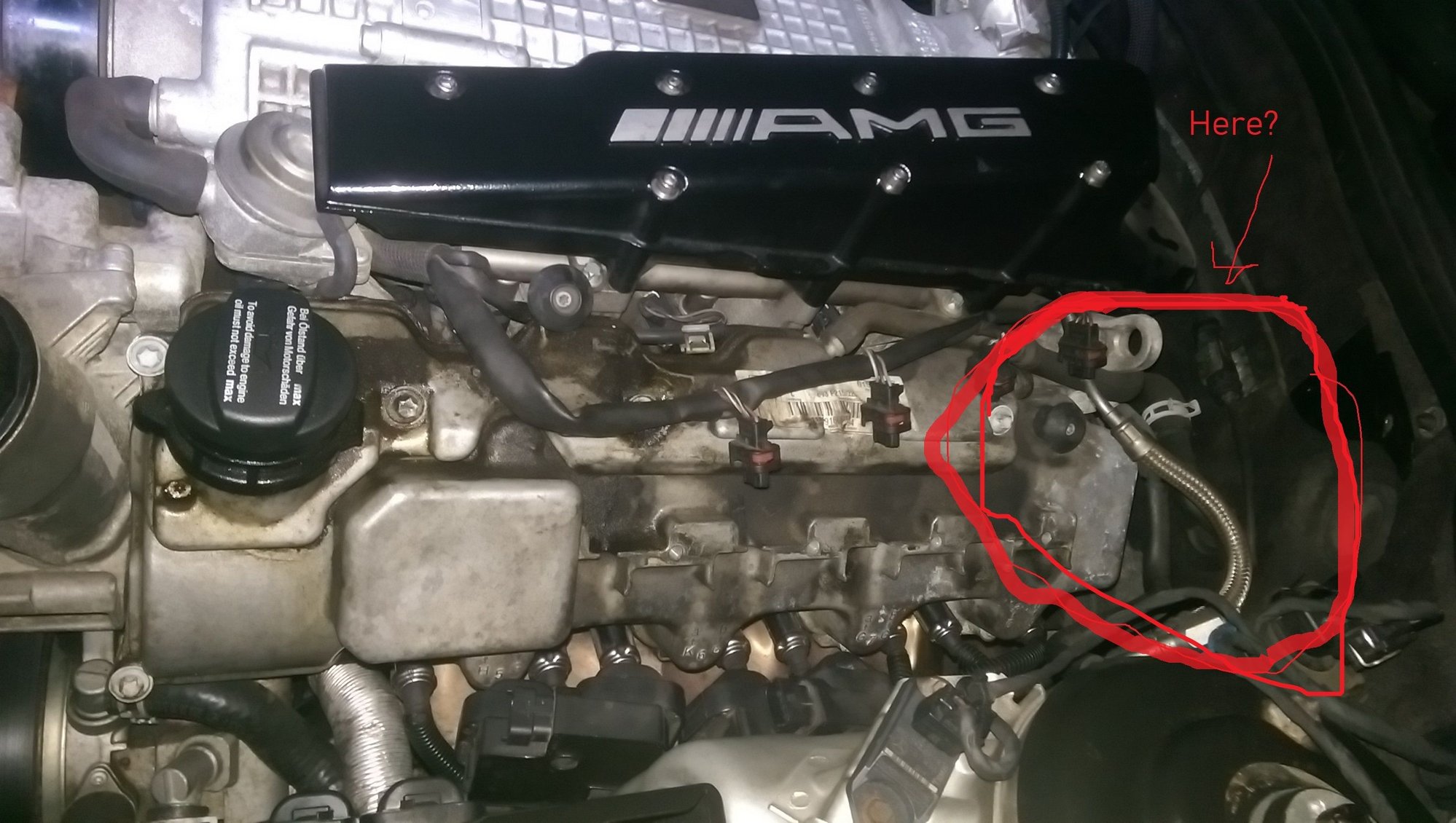

Is the location here where circled?
Any chance there is a picture of this somewhere , I cant pass inspection now with this issue.
I will attempt to find it but at a loss , I saw the bracket ant the pipe dont see anything disconnected
Here is a picture of the valve cove found online I circled a part is this the hose location?.

yes thats the area. it's a metal hardline that has a 90 degree bend into the s/c
