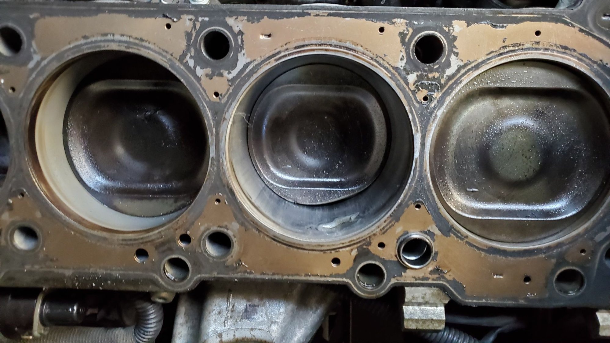

I sure would like to know who pulled my post regarding my blown engine (image on the post) with an 83 mm pulley and tune? I did not name the tuner as the tune was brilliant for 2 years and 20k km before it holed a cylinder.

Please again, I do not believe the tune was at fault. How would a tune go bad, it is a digital file which does not change without human intervention. Bad tank of fuel? But then why didn't the ECU pull the timing if it was detecting knock? Low fuel rail pressure? But again, why did the ECU not protect? Expert opinions please?
Cheers.
