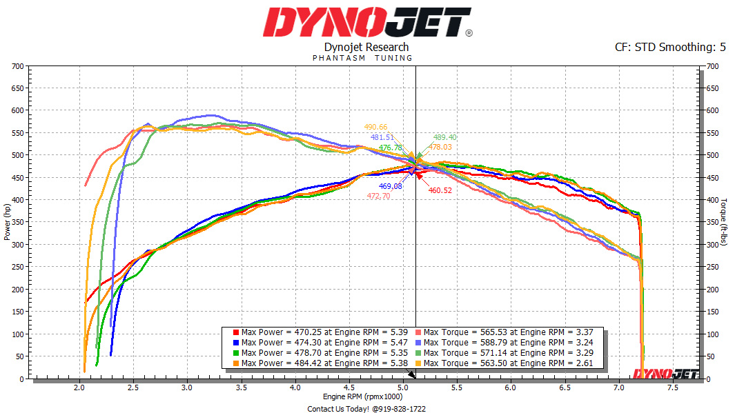

SL55 AMG New Dyno Numbers
I think this is a bit closer to what I'm actually producing however data logs still show timing being pulled due to high IAT temps. Very frustrating that my Weistec dual pass heat exchanger not doing a better job. And no, there is NO air in the cooling circuit, it's been bled twice, both times correctly.
So, when I move to FL I need to find someone that knows how to deal with high IAT/s. If anyone has had success with a vendor in FL, please respond.
Setup is 76mm UPD pulley, RaceIQ ECU tune and MBH Long Tube Headers.
Thanks
Bill

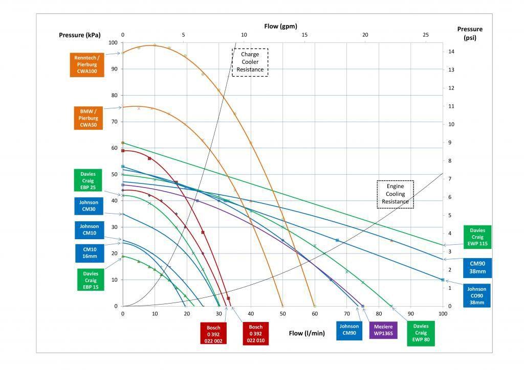

Thanks for the flow chart. I found that graph also post pump swap. I agree, at a minimum I need to get a different pump installed.
I also wondered if piping the 2 HE in series might be another step. At least it will add more fluid to the system although I wonder if the efficiency of the OEM HE isn't compromised by the fact the new one sits directly in front of it, blocking air flow.

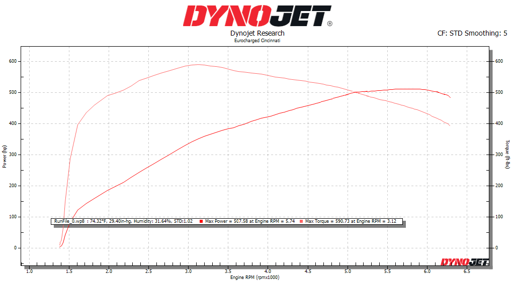

Just got back from EC Cincinnati. Had MBH headers installed. Car has 77SCP, EC HE.....so very similar to your seup. Dyno numbers, 507rwhp, 590 torque. This stock 74mm TB, which will be upgraded to 92mm Hellcat TB in a couple of weeks.

If you plumb the original HE is series AND before the new HE (relative to its order in the flow), it should not make a difference that the new HE is in front of the original HE. The original HE will serve as a pre-cooler for the new AND it will increase system capacity.

note: this was with the OE and EC HE in Series with Bosch 010 pump. After third pull, power had dropped to 497rwhp...

Just curious where the you got the system curve in the pump chart? Do you know if it considered the piping between pump and charge air cooler?
Old Mar 24, 2022 | 09:59 PM
latemodel21's Avatar
Joined: May 2009
Posts: 1,187
Likes: 239
From: Santa Clara, Ca
2003 SL55 / 2002 SLK32
The Chart is from this Thread
https://mbworld.org/forums/m275-v12-...ion-pumps.html
it first appears in post 24. I expect your questions will be answered there (plus/minus a few posts)
