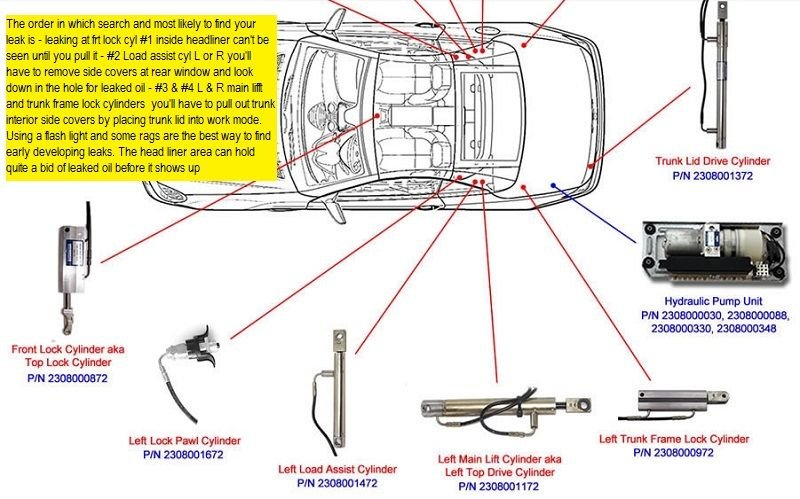

Only when you pull (see attached lay out, compliments of Top Hydraulics) will you see/discover the source of the first signs of a leaks.
No STAR does not.
It may be a pin hole in any one of the cylinder seals with hardly any noticeable fluid loss in your reservoir but the pressure drop in the system is the reason it takes more time to open/close it and depending on how often you close and open the roof (& temperature) it will accelerate the point and time where it will fail.
A life cycle of 10-12 years is perhaps as much as can be expected for any one of these cylinder seals. I just completed the replacement of all cylinders on my 2007 and now have a 2009 in house that needs the same.
There really is no band-aid solution for these things ones it shows tell tale signs of failure your better of to plan for a full replacement if you like to have a convertible top that works every time you want to.
Best H
Lay out compliments of Top Hydraulics
