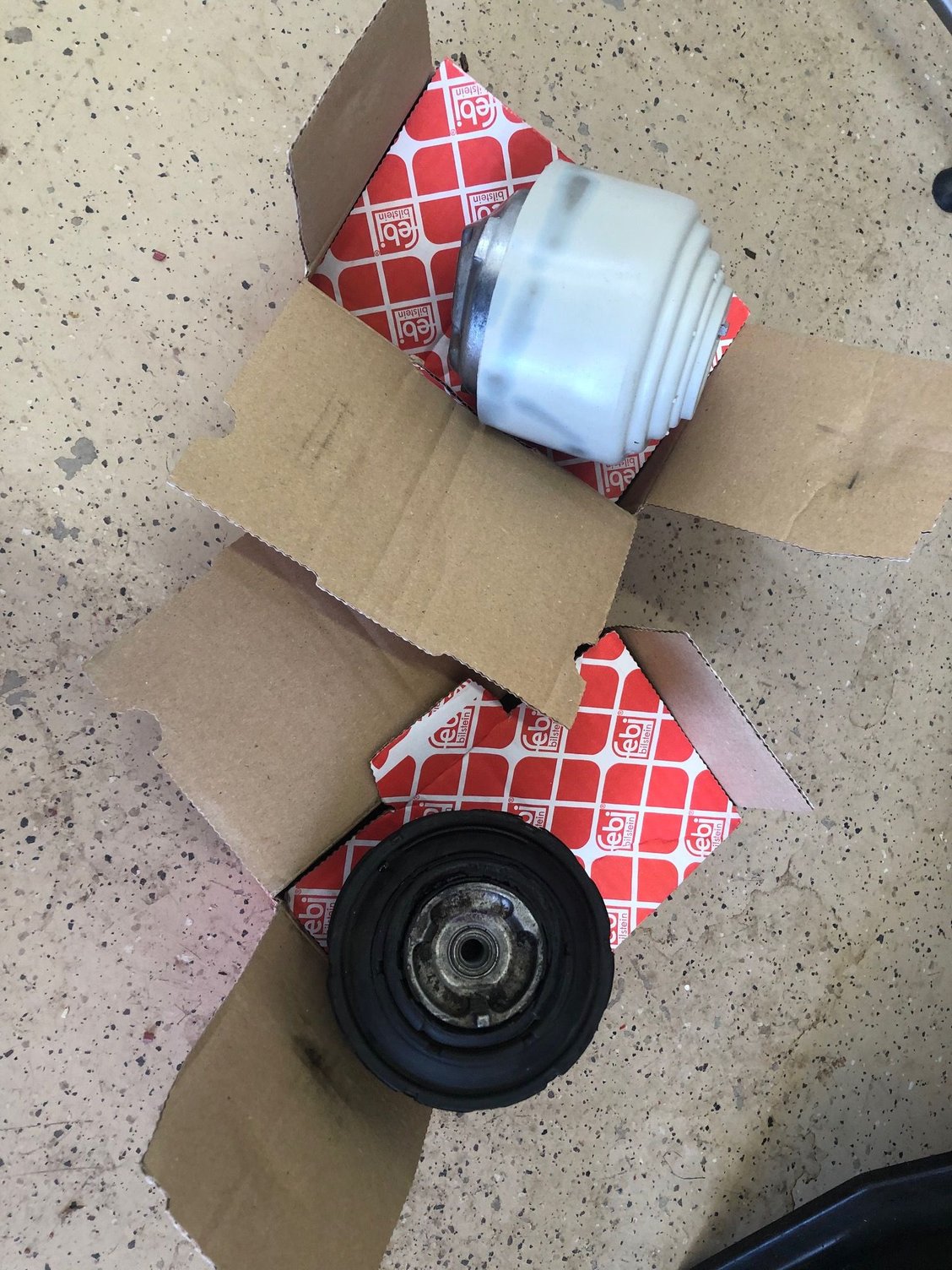

Just sold my '11 Porsche TurboS cab for an '03 SL55!
I didn't get any metal to metal noise on mine and they were definitely shot. Seems there a lot of rubber in there, it's just that the liquid fill part fails. We'll see. F1, I'd plan 6-8 hours on this one.
Because they have metal heat shields around them, you really can't see much while they are installed.
Pic of old and new, but you can't see much.
