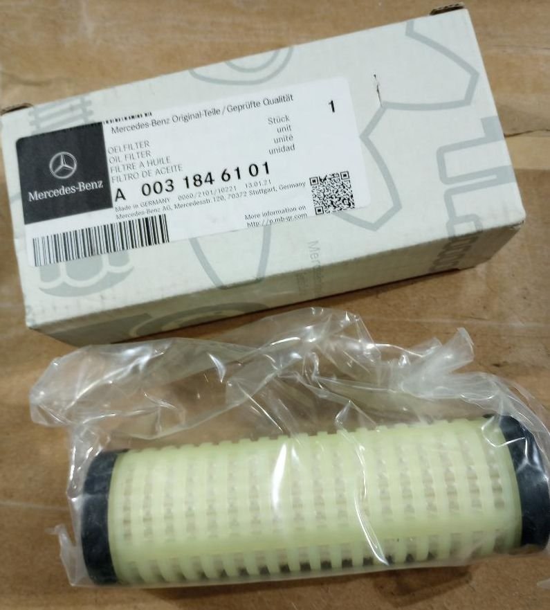

p.s tonylin- isn't that a 3 micron filter.
Old Nov 20, 2024 | 10:08 AM
HLG600's Avatar
Joined: Dec 2005
Posts: 4,057
Likes: 341
From: NJ
2009 SL63 AMG
Upgraded filter is rated at 3 Microns. The original filter that came with ABC 1 was 10 Microns.

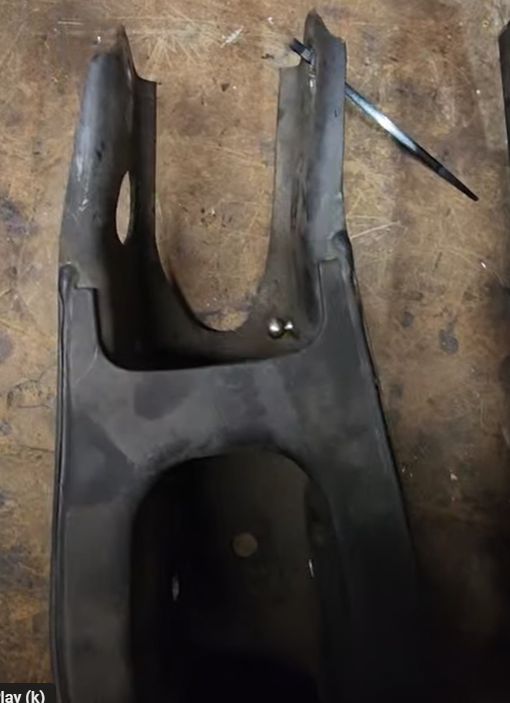

So, an update on this. I replaced all three accumulators and the pulsation dampener, and the issue still is there of a rough ride and the back end kicking to the side over a harsh bump. This was a pretty easy job, and it helps this car spent its entire life in Southern CA, so there is not a drop of rust on it, and all bolts turn as if they just rolled off the assembly line.
So, the next thing I am going to check is the bushing on the rear lower control arm that the struts bolt to. I am going to replace those as I have read that these can cause that issue and with 120K on the car won't hurt. If that doesn't do it I'll probably replace the struts.

So I resolved the issue with the rear end stepping sideways over harsher bumps. In the course of replacing the bushings in the lower control arms, I discovered that the passenger side was bent substantially as well as the bushings being completely shot. I replaced both control arms with new ones, and the issue is resolved!
