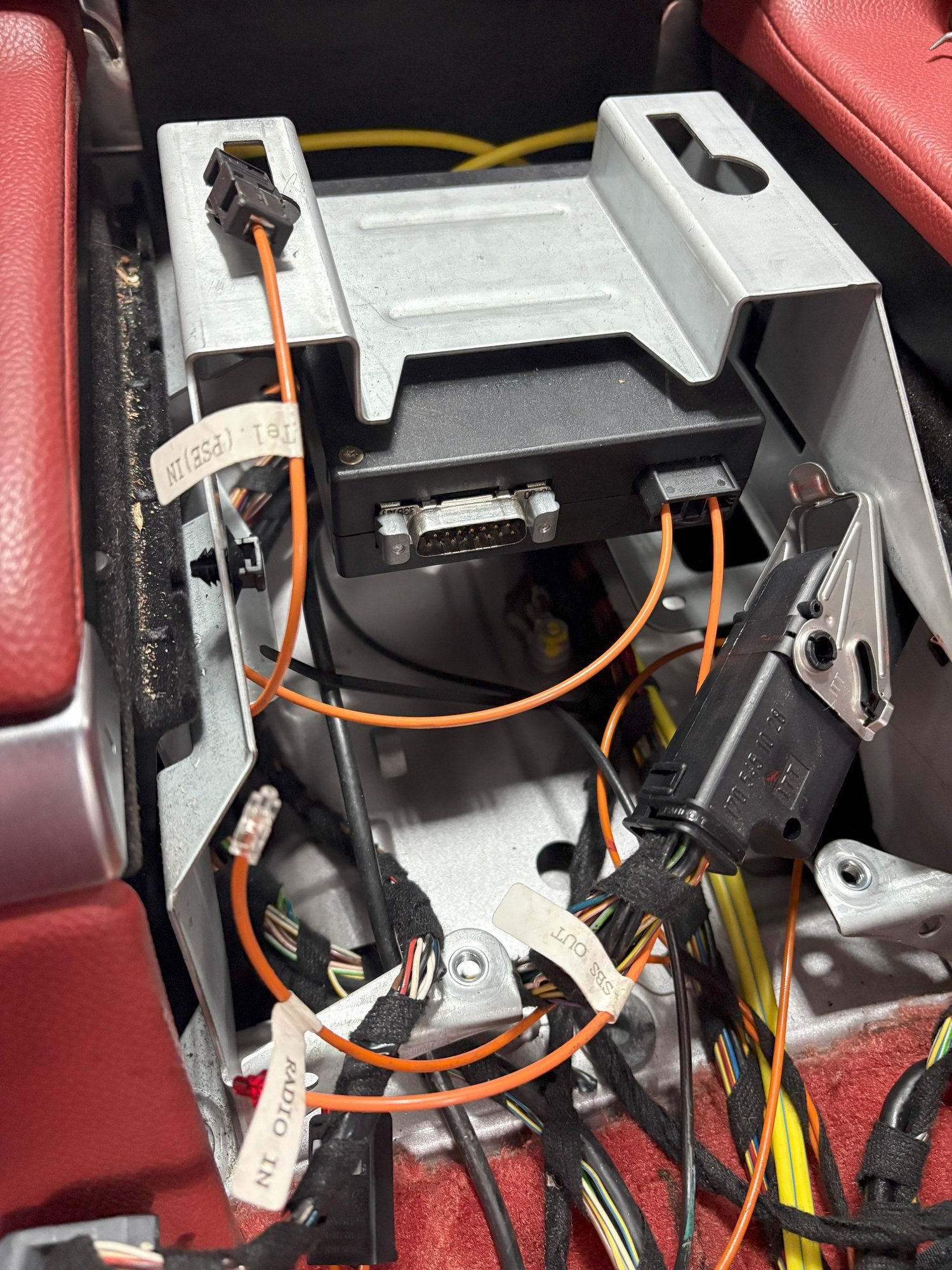

The Tele-Aid module itself is in the the center area between the rear storage bins, some people pulled out the storage bins but i was able to do it by just popping off the center cover (the two screws are in the inside of the center console storage bin). You have to physically reroute the orange fiber optic cable around the module and code it out otherwise when you pull the Tele Aid fuse, the overall system still thinks it's there and you'll have no sound from the amp or cd changer, which is why just pulling the fuse won’t work.
Mercedes sells a $7 bypass connector 0005453384, which i bought but didn’t need b/c I was able to re-pin it into the existing connectors.
Here's a video from on YT (credit to the creator, Žanas Tumasonis) that I followed:
To code it out you’ll need a bi-directional tool—i used a Autel MaxiPRO MP808S (abt $450) but there may be cheaper units that can do it. I know the $100–150 MB iCarsoft units didn't have the capability. You’ll have to go into both the D2B/MOST and SRS/Airbag Modules and uncheck “Tele-Aid” as an option. The D2B is the obvious one but if it isn’t coded out of SRS, you’ll get an SRS light.

Now, Was I supposed to code the Tele Aid Module out before I removed it? I pulled it a linked the fiber cables first, then went to DAS, but Under Communication > Tele Aid, DAS can't find the module. So not sure how to deactivate it??

Found the Attached MB Service Bulletin that lays out a DSA path in detail. Also, I've attached pics of the Motorola Branded Telephone (Telaid) including the p/n. Also, a pic of the mounting stricture with the teleaid box removed. It is below the Voice Recognition box, which I also removed later. I'll update you on this DAS path after I've used it.
