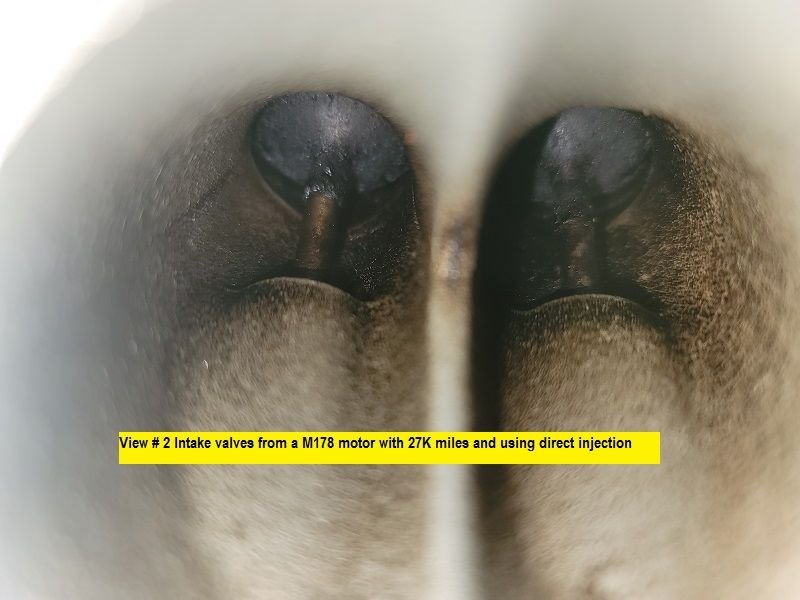

I'm in the process of taking (2) 4L Hot V's engines apart a 27K milage and a 7k milage unit I'll be taking some pictures of the intake ports to see what they look like and post them here.

Crushed Walnut Shell Blasting
I assume that you are talking about walnut shell blasting when the heads are of?
Best H
BMW “invented” the process of walnut shell blasting. They do it with the heads on for their 4 and 6 bangers. They rotate the crank so the the valves are closed on the cylinder(s) they are blasting. . Not sure of the BMW process for a V8. I asked my Indy shop that also have the walnut blasting equipment. He said he can do the AMG hot V, but it’s expensive because of the location of the intake manifolds and all the stuff they have to remove to get to them. The plus side is you’re not pulling a traditional V intake manifold with the coolant running through it. I just consider it maintenance on a high end engine.
I’d be interested in seeing picture of the intake valves.
Hereby 2 pictures of the cylinder head intake ports from a M178 motor with 27K miles on it, I'll soon be taking one apart with 7K miles on it and will make some shots of those to compare.
Best H
Best H
thanks for posting these pictures. I want to make intake valve and runner cleaning part of my periodic maintenance. I just didn’t know the interval as MBZ has no service available as they claim this is not a problem (we’ve heard this before with the 6.3L engine). Looks like every 25k would be a good time to get it done.

Dry ice huh? I used walnut shells on Volvos in 1989.
Sure looks like 25,000 miles is plenty long enough on the DI Mercedes intake.
