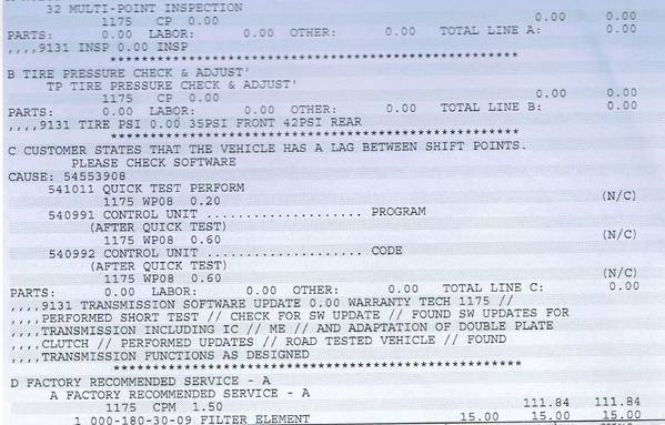

SLS AMG Service A1 and transmission software update.
Damn near broke the bank!
The transmission update is worth doing! I can't really put it into words but, the car reacts so much better!!
Thank You for posting! > https://mbworld.org/forums/sls-amg-g...ml#post5997017
(They found no upgrades for AMG Performance Media.)

Did I read the price correctly for service A? I just paid $500 which is inline with the build on Mercedes' web site.

Correct. $185.95 was it. Mercedes Benz Laguna Niguel. Christian Williams service advisor.

I printed exactly this. I took it in to my dealer and said "My transmission was laggy and slow to shift. I would like this update." Then I shut up until they said OK.
William Vetter who is head of AMG and Black Series vehicles for MBUSA
"Here are the details which should be all of the info that you (and the dealer) need:
TIPS Document: LI27.60-P-051188
Coverage: 197.377 & 197.477
Subject: - Procedure in case of complaints regarding shift quality and start-off behavior -
The procedure will:
- have the technician document your complaint (shift quality, etc)...
- they will download some packets of data from the transmission controller...
- they will then see if there is newer DCT software applicable to your vehicle (keep in mind that your vehicle might be already at the most optimized software)...
- if there is new software, it will be loaded into vehicle and configured (via SCN Coding)
- procedure is then complete
Note: this notification is applicable to the USA market, customers in other markets should refer to their local dealer to determine applicability"
