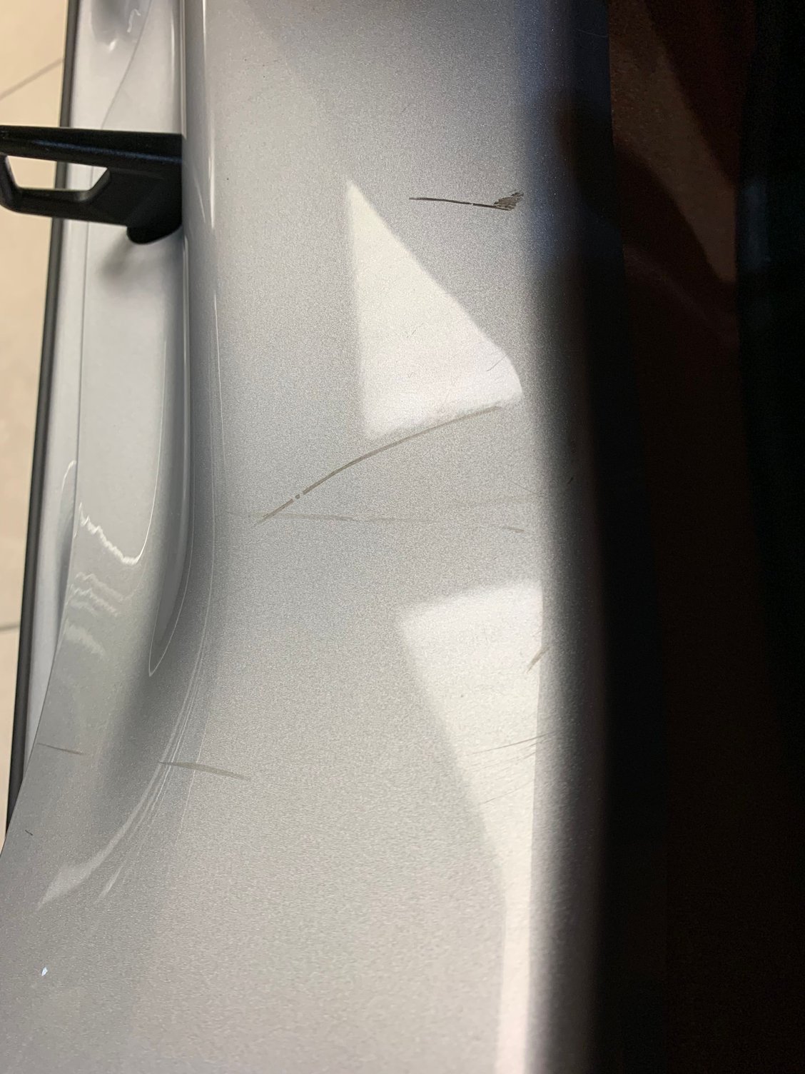

How difficult is it to replace this? I imagine it’s not easy to buff these scuffs out, because this part is plastic.

Why do you need them off? If for repainting them, you can take them off after removing the LEATHER part and taking the screws out(iirc it's 2 screws),the plastic is held by double sided tape.
You can take the plastic cover off without removing the door lock.

Thanks, great info.
I am thinking of replacing the sills with new ones since I’m not sure if the scuffs can be buffed out.

No need to replace them...Just have them repainted or have them done in Carbon Fiber.

Try using McGuire’s Scratch X on the scuffs, and if not satisfied have that threshold piece repainted. On the last photo, I would guess that might be the work of a rodent. I picked up a low mileage Porsche with a similar insulation appearance and the technician cited rodents as the root cause.

However you repair the sills, repaint or buff, I would highly suggest having them covered in clear bra. I had mine done when I first got it and it's saved the sills from a ton of scratches.
