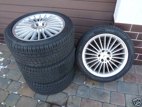

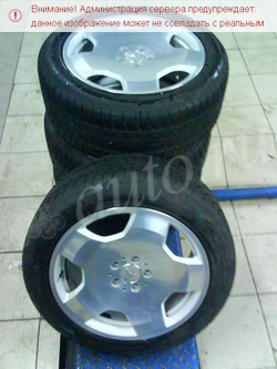

No that bad 17th are fine, now it is on 17th and this is the limit. Having discussed it with friends final decision is:
1. All 4 will be 8,5J
2. ET starting from 37 and less up to 25 maybe
3. Tires all 4 - 245/40/18
Probable variants are:
1. MAE 18, 8,5J ET25
2. AMG 18 from SL230, 8,5J ET30, seems perfect
3. Lorinser, but they are 19th and 9J, ET35
4. Carlsson 18, 8,5J, ET39
5. Last is from W221 ET43 - not good at all, but seems to be looking cool
What do you think guys?
