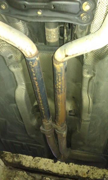

Hi .. Manage to snap a shot of the exhaust system. So the x pipe should be at the start of the reworked straight pipe ?

you are correct, should be at start of the new straight pipes.. this new pipes has +/- 50cm or 20 inchs. just replace this straight pipes with a Summit Racing x-pipe & aaalll good
