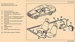

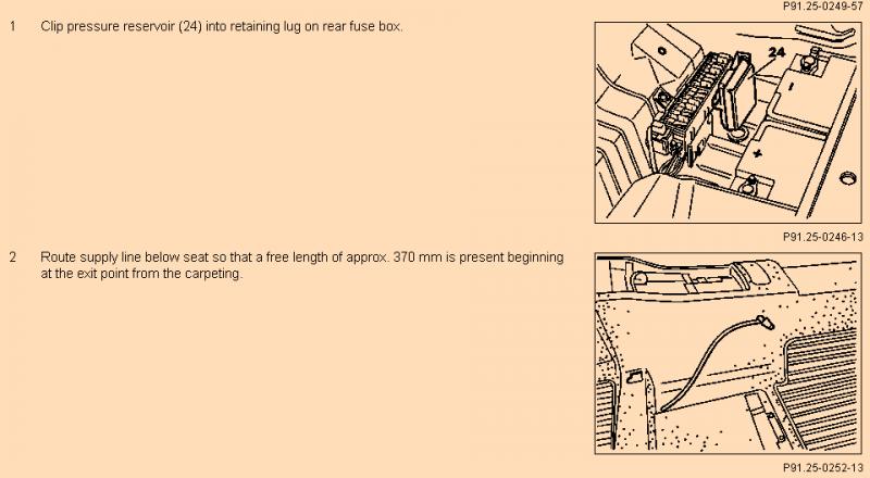

Here are some screen shots from the WIS:
AMG E55 W210 Multi-Contour front seats WIS info?-screenhunter_52-jun.-26-20.11.jpg
AMG E55 W210 Multi-Contour front seats WIS info?-screenhunter_54-jun.-26-20.14.jpg
AMG E55 W210 Multi-Contour front seats WIS info?-screenhunter_55-jun.-26-20.14.jpg
Hope this helps

Anyone have details on where this hooks up to the vacuum pump? I guess it probably depends on the vacuum pump you have but how is one supposed to figure that part out?
I also wasn't sure which of the two lines going back went to the pump, but from these diagrams it looks like the one coming off the middle of the "T" fitting does.
