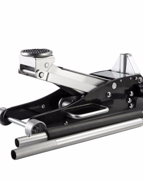

That's what I'm using, but the front lip on the car is still too low to get the jack under without first driving up onto the blocks. I have a Michelin branded version of this unit:
http://www.canadiantire.ca/en/pdp/mo...1036p.html#srp
There are lower profile versions, but I also own 2 4x4 SUV's that need to be lifted high to get the weight off the tires, and keeping the blocks around makes more sense than buying another jack that I'd only use on the car.

Ian, I used to do the same as you, until I brought a 2 ton Sears aluminum racing jack, the front is less than 4", I can push the jack under most vehicles. However, I do have to put a wood block to lift my pickup or Range Rover, these trucks have higher off ground frame.
If I have to choose between driving up on wooden blocks or jacking with a wooden block on the jack saddle, I'll choose driving up on the blocks every time. Much safer alternative given the 2 choices IMO.
