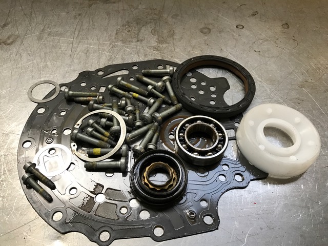

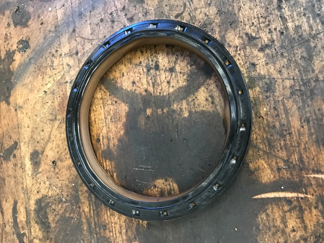

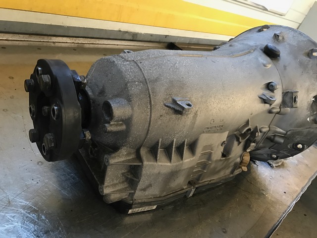

If you discover small drips of oil coming from the front of your transmission it could be a leaking oil pump/governor seal. It is an easy/moderate fix.
While there, replace the output bearing and its seal as well, it will be worth it and it all costs under $70. Some labor is involved of course
When putting everything back together, use new installation material. Good luck!
