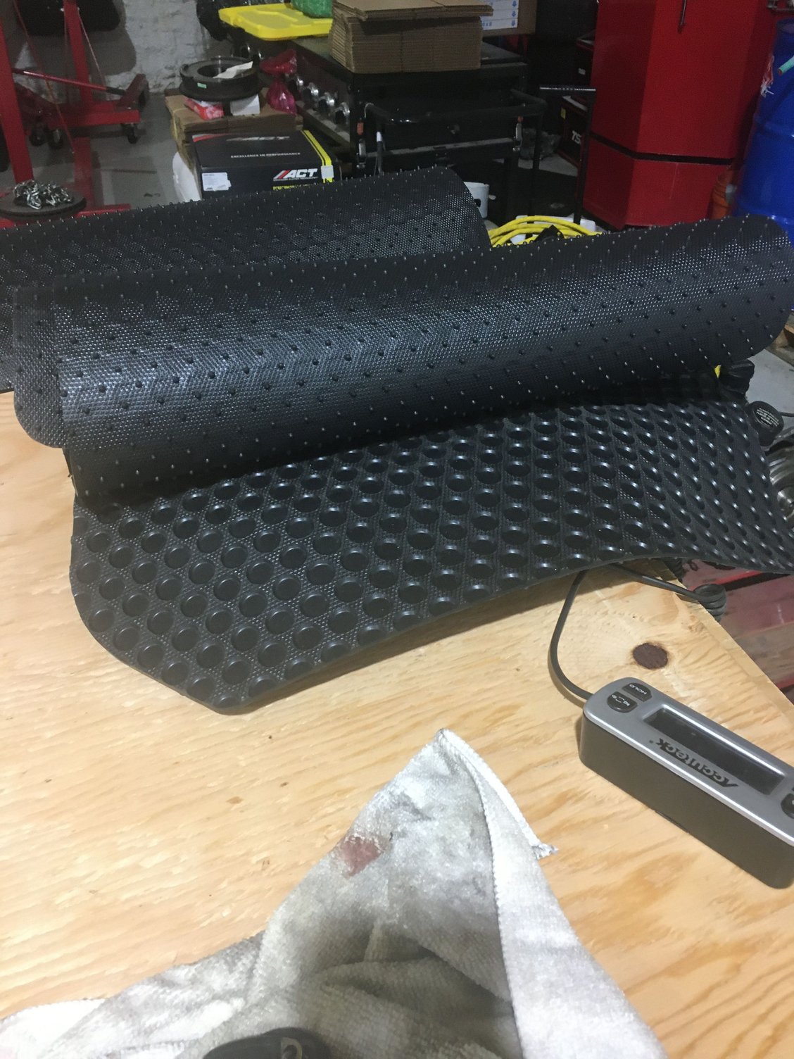

Old Nov 19, 2020 | 12:45 PM
  #98
eurochargedw210's Avatar
Joined: Oct 2017
Posts: 670
Likes: 103
w210 E55
Also my new custom floor mats, these actually saved 5lbs over the old rubber honeycomb mats.
