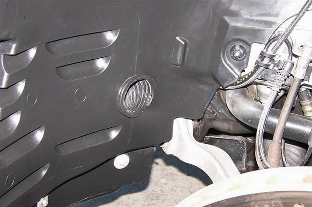

I have done my brake ducts behind the right fog light cover and on the left, inside the lower grille, next to the partition with left fog light cover (no room there)
It was very tight but I did manage to thread the flexible hoses into the wheel well. Don't forget, that a lot of the heat in your brakes comes from the ABS/ESP which constantly comes on as you go around the circuit, and you cannot completely switch it off!
