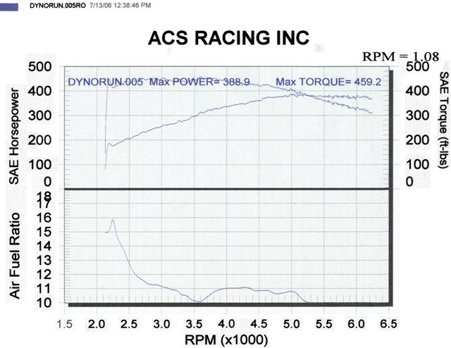

S211 AMG
I got my wheels redone this morning with the correct conditions.
Vrus, you still think it's low? the A/F dropped below 10 which I was told was not measurable.
Old Jul 13, 2006 | 01:21 PM
Kev04C320's Avatar
Joined: Jul 2004
Posts: 4,330
From: Seattle, WA
'09 911 C4S
Dude, you should've called me and we can go together.
Old Jul 13, 2006 | 01:22 PM
vrus's Avatar
Joined: May 2004
Posts: 3,797
From: Richmond Hill, Ontario
2003 E55 AMG
Your car is running a bit too rich.. You are at 11:1 through most of the RPM band.. Either the supercharger belt is slipping like crazy or the ECU is dumping fuel for some reason.
Open your hood, remove the plastic cover at the front of the engine and look for black dust on your pulleys, underside of the plastic cover.. Also check for belt wear on the edges.
It most likely is belt slip.
OR
You've got a car that was originally modified with pullies, headers, ECU and was put back to stock, but the P.O. left the modified ECU in it. Do you know the history of your car?
Old Jul 13, 2006 | 02:17 PM
Fleebee's Avatar
Joined: Mar 2006
Posts: 297
From: Boston
S211 AMG
Vrus,
No I don't. I bought it with 10k on it and a year old. It did sit for about 6 months before I bought it so if the mods were done they would have been installed and removed before that.
I'll check for the dust.
Re: A/F what would you expect throughout the RPM band? I assume the flatter the better and certainly the dyno tech said that I was loosing it at high RPM.
You mentioned to Jrocket that it was unusual to see a completely flat A/F
