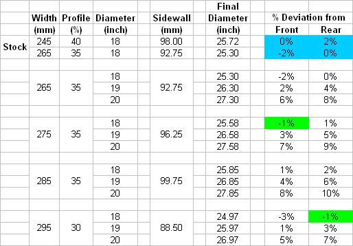

I'd be most careful with keeping the overall diameter consistent. If not, you WILL have ESP issues under any spirited runs. If you only care about looks, I'd say your setup is close if not right.
I'm running 275/35/18 on the front and 295/30/18 on the rear with no rubbing at all. It is close, but no rubbing at all and no rolled fenders. It at least proves that the setup will work, IF you get the offset right.

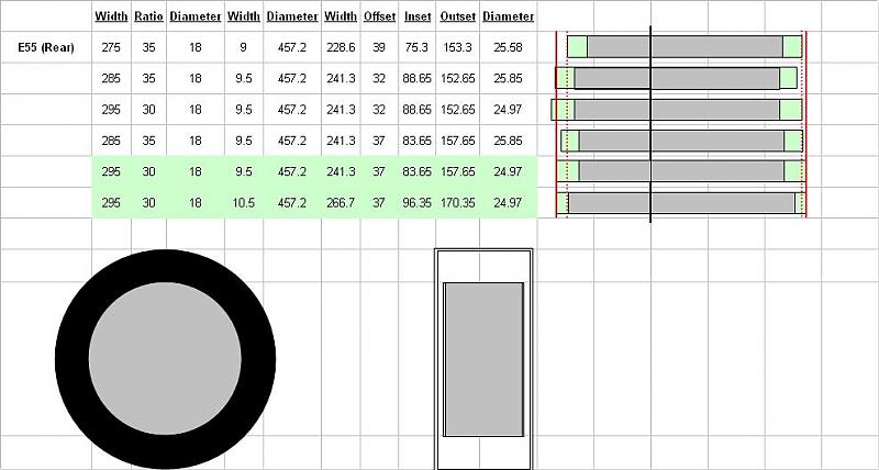

I'm running 18X9 et39 in the front and 18X9.5 et37 in the rear:
Attached Thumbnails 285/30/20's on 42mm offset 20x10-wheels.jpg

You need to be careful with rubbing on the INSIDE. It may fit perfectly at first, but the toe will shift as you apply power and could cause the rubbing. Other than that, i think you are close.

Actually, E55s come with the larger size (diameter) up front. I am less worried about getting the two to match eachother, than to stay as close to the OEM diameters. My current setup is 1% plus or minus on each axle. I've run 255s and it isn't enough meat for me. I'm HUGE on handling and I love the current balance. the only change I want to make is getting wider and lighter rims.
As for your point about going even larger in the rear, it is well taken. however, the emphasis on my project has been to NOT require modifications to suspension points or fenders. After all, how can i talk a wheel manufacturer into making a custom set when they will not be able to market it? as it is, whomever ends up working with me will have the first and only setup that runs 275s up front and 295s in the rear. Currently, only CCW specs to 295s and even they require specific tires. I wish that they would try a slightly more aggressive offset as I believe it would solve their issues.
In the future, I plan to roll the fenders and go with 285 fronts and 305 rears, but that is more when the car is making huge power and has rebuilt arms under it..

Here is a followup to see what I mean:
https://mbworld.org/forums/attachmen...3&d=1171170648

In general, I would NOT go over 5% more or less in diameter than the OEM setup. You never said what your intent is? Is it solely looks? Any spirited driving? if so, don't do it, since ESP will be kicking in very fast. If all looks, then do it.
