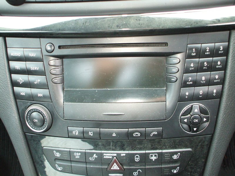

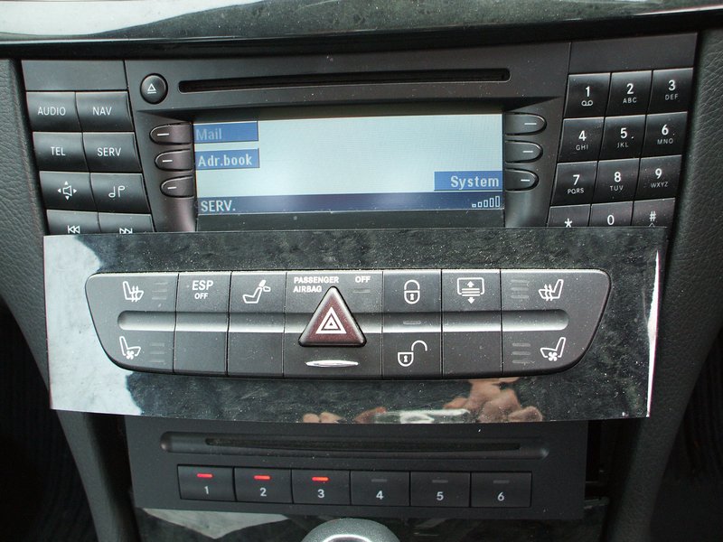

Heres some pics of my comand unit.
Can anybody tell what command unit i have from these pics ?
Thanks 4 ya 'elp.

That is definitely a w211 console, they appeared in 2002 in the UK. The 3-5-7trick won't work as you have an aps50 nav unit and not the dvd nav unit.
Don't quote me, but your car probably has the MB gateway already wired in, so you could change up to the dvd nav unit????....this would enable you to install tv and play dvd's straight from the head unit.
