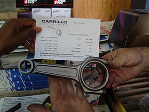

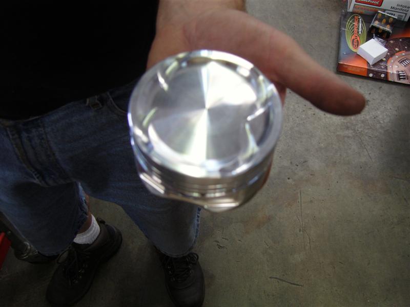

........Just got back my pistons and rods. Here is a pic. Not much to see but I'm very excited.
Ted
Attached Thumbnails Custom pistons and rods-snc10328-medium-.jpg   Custom pistons and rods-snc10329-medium-.jpg

YEEEEAH brother, Carillo H-beams are made of Adamantium. I have them in my Sup!!!

.......yea! I am going to turbo my E. Currently reinforcing the internals. Hoping to make it bomb prooof. I plan to do it right, but it is taking so much time because everything is being custom made as there are no pre-fabs for Mercedes.

Looks great! Who's pistons are those? JE's? How long did it take to get them?

What coating are you running or do you plan on sleeving the engine?

Nice, Ted are the pistons coated? Are you going to use stock rings or total seal?

Yatchmaster and Blown V8, you are quite right in that you cannot just use after market pistons because of the nicoseal coating on MB engines. So the cylinders are getting sleeved. Entire engine is essentially getting rebuilt for high boost tolerance.
JamE55, the pistons are locally custom made. They have taken 8 month to get them made.

Are the bores Nikasil or Alusil? If the bores are Nikasil coated, you can run an aluminum piston in the bore. If the bores are Alusil, you must run a coated piston.
Sounds like you are doing the right thing by sleeving the engine. That way, you don't have to worry about the bores and you can use JE pistons which are about 1/4 the cost of replacement Mahle's.

.............thanks. I decided to sleeve the cylinders partially for cylinde wall protection and partially to be able to run aftermarket low compression pistons. The cylinder walls in Mercedes engines including the AMG ones are amazingly thin. The engines were built no to be repaired or re-used.
