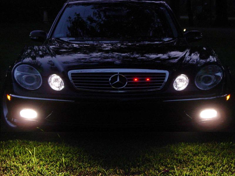

Got the car back from Adam yesterday and had a chance to fix the problem with the fog lights last night. James stated that the E55 supplies a -12V source to the fogs. To fix the problem, I just needed to reverse the wires on the supplied harness that connects to the factory 9006 connector. All is well. No errors or flicker. I'll post pics later when it's darker out. Quality stuff so far. The 6000K is a touch more purplish/bluish than the stock HIDs. Just a tad. It looks really good and far from looking like a ricer. It is also much much brighter than the stock halogen fogs.
I did notice that the power supply to my fog lights was reversed (brown +) in a short 6" plug to plug extension.I discovered this when I taped a 12V feed for my beast eyes. Glad you got yours working (I ordered mine 2 days ago).
The before HID, this is what 9006 silverstars look like.
BTY my city lights are from Pep Boys too. I tried all the others easily spent $35 for all the possible whitest lights, and still the Pep Boys "hyper white" bulbs were the whitest.

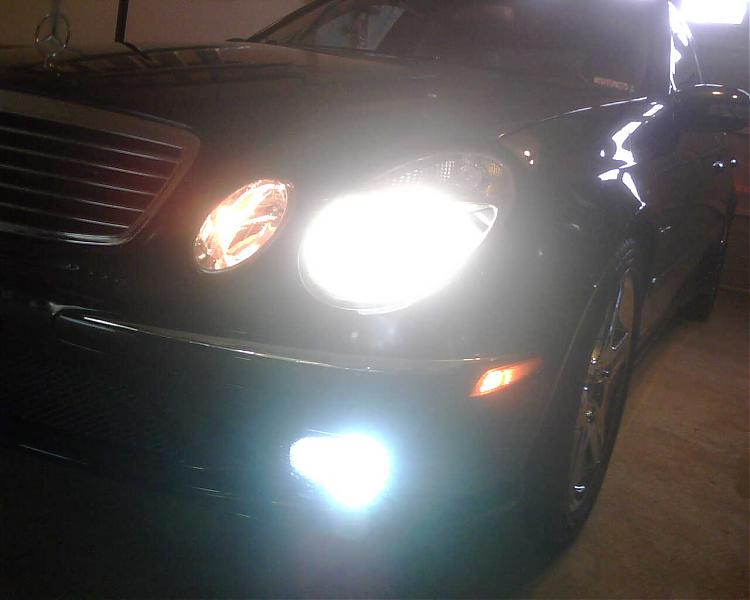

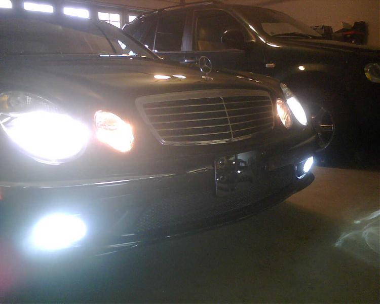

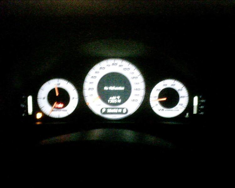

Here are some lousy (I mean really lousy) pics
James - Here are some lousy pics taken using my phone. Aside from my camera (or is it the loose nut behind the camera ) malfunctioning, the last picture shows no malfunctions on the dash.
Attached Thumbnails How about a little Light-img00032.jpg   How about a little Light-img00033.jpg   How about a little Light-img00043.jpg   How about a little Light-img00041.jpg   How about a little Light-img00036.jpg
