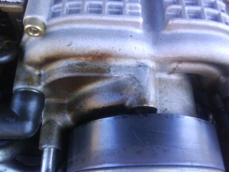

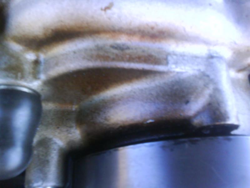

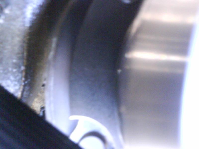

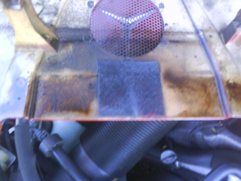

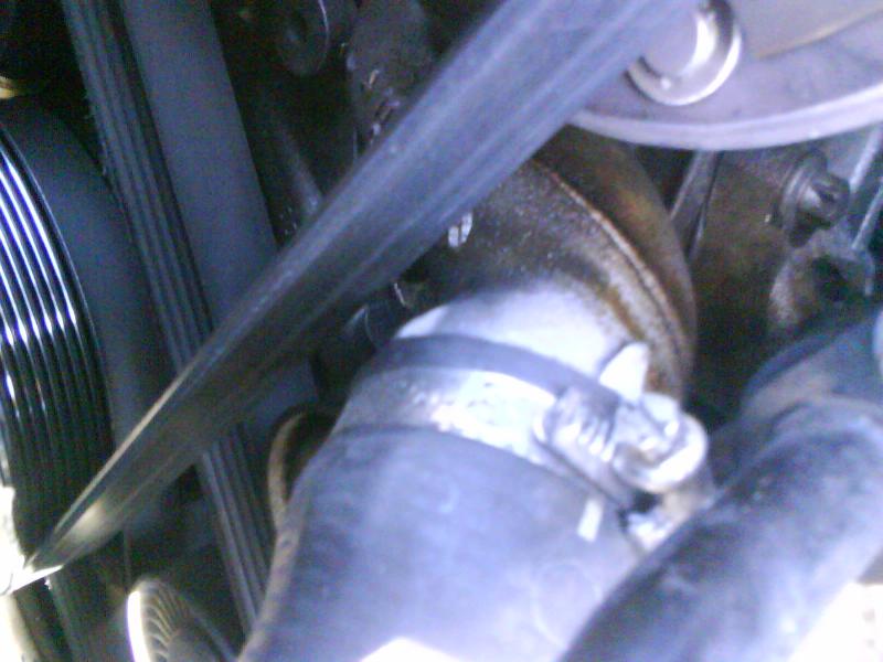

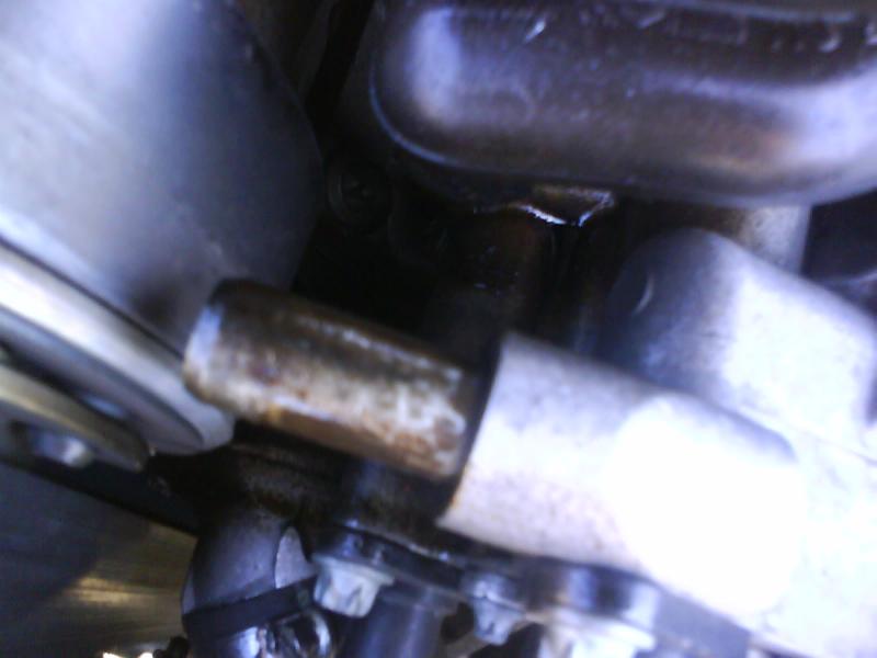

Driving down 163. Got off freeway at Friars and got to stop light..... smoke was coming from engine thru vents. Immediately pulled over at Fashion Valley behind the Firestone right there and opened the hood to let it cool (I thought worst case scenario, Firestone should have a fire extinguisher...) and got my whip towed to MBSD. Looks like fluid was leaking and was going onto pulley and that is where is was smoking..... whatcha think? Not sure if it was oil.... transmission fluid or what.... probably find out tomorrow
Attached Thumbnails Car got towed into MB San Diego today-dsc00181.jpg   Car got towed into MB San Diego today-dsc00182.jpg   Car got towed into MB San Diego today-dsc00183.jpg   Car got towed into MB San Diego today-dsc00184.jpg   Car got towed into MB San Diego today-dsc00185.jpg

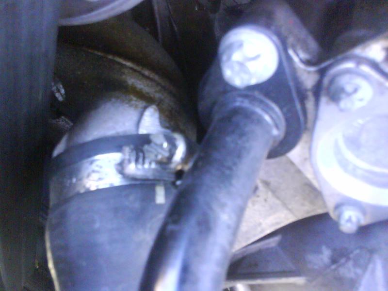

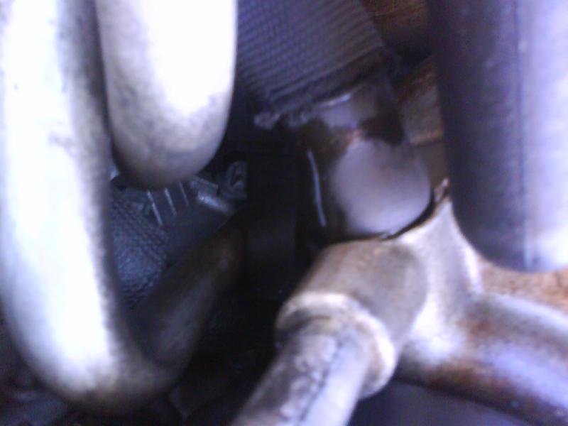

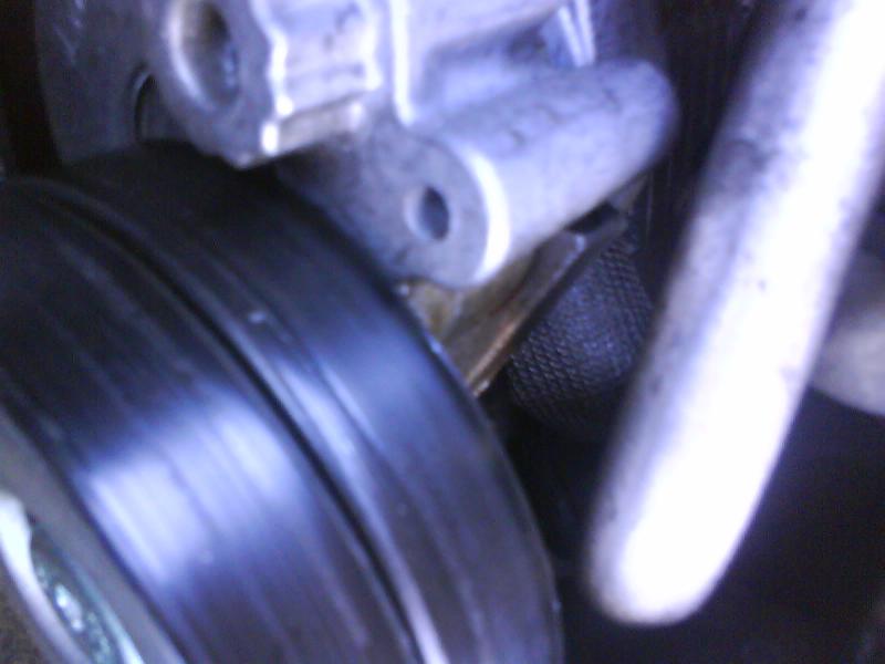

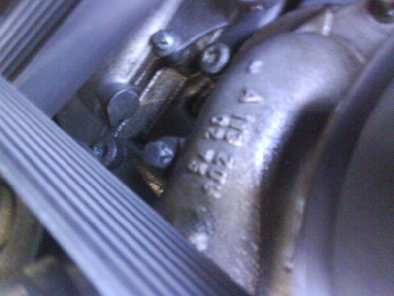

more pics... sorry took them w/ camera phone
Attached Thumbnails Car got towed into MB San Diego today-dsc00187.jpg   Car got towed into MB San Diego today-dsc00188.jpg   Car got towed into MB San Diego today-dsc00189.jpg   Car got towed into MB San Diego today-dsc00190.jpg

Do you see a leak at the bottom of the car? If it's red that should be tranny fluid. I'm guessing it's more like engine oil. Maybe bad valve cover gasket? Keep us updated. Hope it works out.

Not red.... think it is oil but not sure.... might be oil from the supercharger? Seal right there possibly? Clutch? No oil on the bottom of the car. It looks like it just leaked all over the interior engine parts on the front side. Like I said, they did replace that top pulley (whatever the hell it's called?) cuz my bearings were completely fried last November, so if its that, it would still be covered..... hopefully find out tomorrow... in the meantime

White smoke coming from top of that pulley where most of the oil had leaked onto the belt..... right on top under the engine cover.....

Looks like a valve cover gasket blew out. If so, it's a cheap fix for DIY. About $80 in parts and 2-hours of labor for DIY. But the dealer is likely to charge an arm and a leg for that job. It's not exactly easy because you have to take off a number of things.

Any info from the dealer yet? The more I look at your pic, the more I'm feeling that its an awkward place for oil to be coming out (gasket is on the V cylinders, but your oil is coming out near the SC clutch). But not withstanding a complete failure, I can't see how oil can blow out other than from the valve-cover gaskets.

Supercharger front seal?
Could it be the seal to the input shaft on the supercharger? Am not a expert on these superchargers but if they are like typical Roots blowers (ours is a twin screw), they use gear oil in both the front and rear case. Perhaps this is gear oil from the supercharger? A hot engine would cause the oil to smoke. I had a seal go out on a centrifugal Procharger once and it did something very similar. At least you noticed it. Would be a b*itch to have the blower seize on you.

Needs new supercharger!

Some kind of seal in the interior of the supercharger broke that they basically can't get to = need whole new supercharger (think he told me preliminarily $4800 for new supercharger) Should be covered under mb extended warranty (chrysler). Find out more tomorrow.... you know, there is only a couple of more parts to replace and I think I'll have replaced everything Ok, back to my other comment, when this thing is outta warranty, I am gonna throw it away.....
