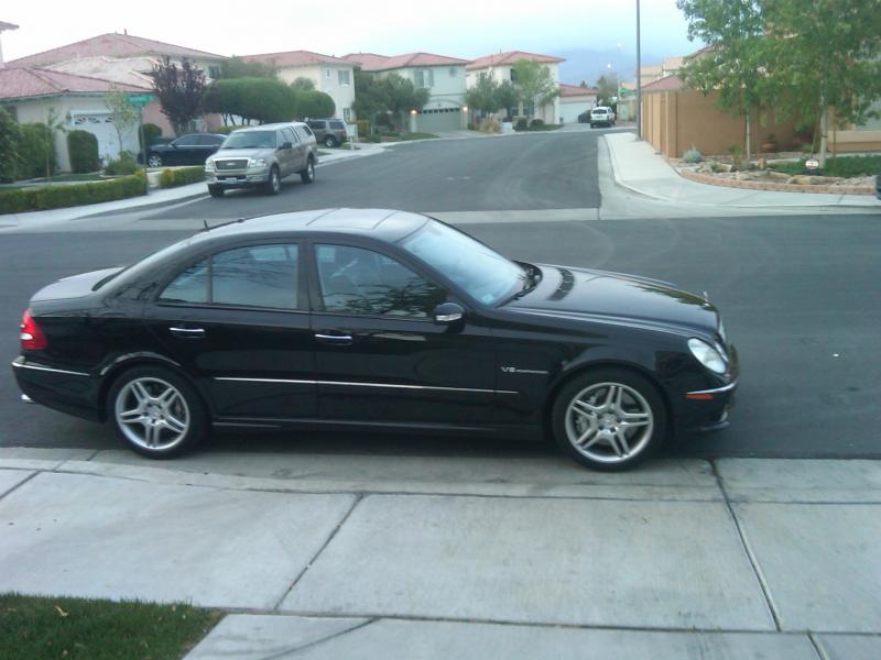

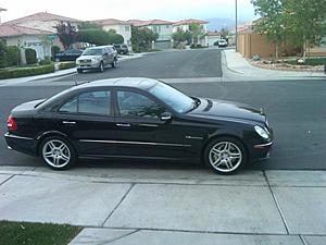

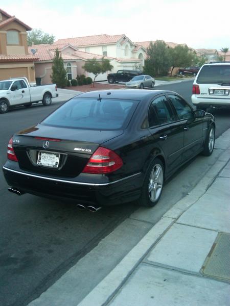

hey guys, i'm new here and to the mercedes cars. i just sold my 2003 mustang cobra and picked up a black 2006 E55, which i have fallen in love with for the week i have had it haha i'm looking forward to checking out this forum much more.. i attached some quick pics i took with my phone when i first picked her up, more to come..
