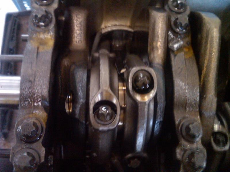

I had a block built that I bought from a member on the forum. He had custom Wisco pistons made from the stock pistons. The block was checked at a machine shop and assembled by an MB mechanic. The Mechanic mentioned the play and said he was not sure what would happen, since he just workes with MB parts.
The question is: The stock piston to rod clearnace is tight but the rods float on the crank on the MB. The Wisco`s were made with more rod-piston float for some reason than the stock tolerences. Anyone see a problem with more piston to rod clearnace than stock? Anything I should check before selling or installing the motor? Pistons also came with Wiseco wrist pins and those were used.
Anyone running aftermarket forged pistons and know how they were set up?

Check out the gap between the two rods in the picture. This is how much float is on a stock 55 crank assembly.

so are you saying your rod is guided from piston? because some are.how much rod side clearance do you have at crank?.floating rod just means pin floats through rod.piston guided rods is somthing fairly new/differant nascar style.does rod bump side of piston before big end bumps crank.or other way around.i will check on that motor today.

did not see picture before reply.you have a piston guided rods.piston you have are wrong.you may be able to make a guide that floats between rod and piston.call wiseco

The whole motor is together and going in today already. Just checked and we have piston guided rods not crank guided rods. I guess the member that had these pistons made, may not have known how our rods were guided. I did not either, when I tried to check everything before sending him a HUGE bank transfer!
Stock rod width is .785 and stock piston ID at rod is .795. The custom piston is .950! That means I have .155 more side play than stock? To much? Will it still align or will a 45K motor go Kaboom on the first run? From what I understand, .165 rod to piston play is ok on a motor that is crank rod aligned driven verses piston rod aligned.
