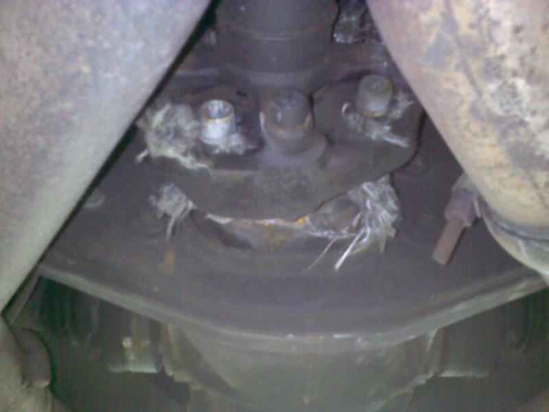

found it and getting it repaired very soon.
Hope I have not damaged anything else whilst I have been driving it, like the gearbox-propshaft-diff.

Difficult to see - did something get caught around the propshaft - or did the rubber connection fail?
rubber flexi disc has come apart, this is made up of a mixture of rubber rope/string internally.
Fixed and now I am able to drive without the flexi joint bolts hitting the rear diff.
