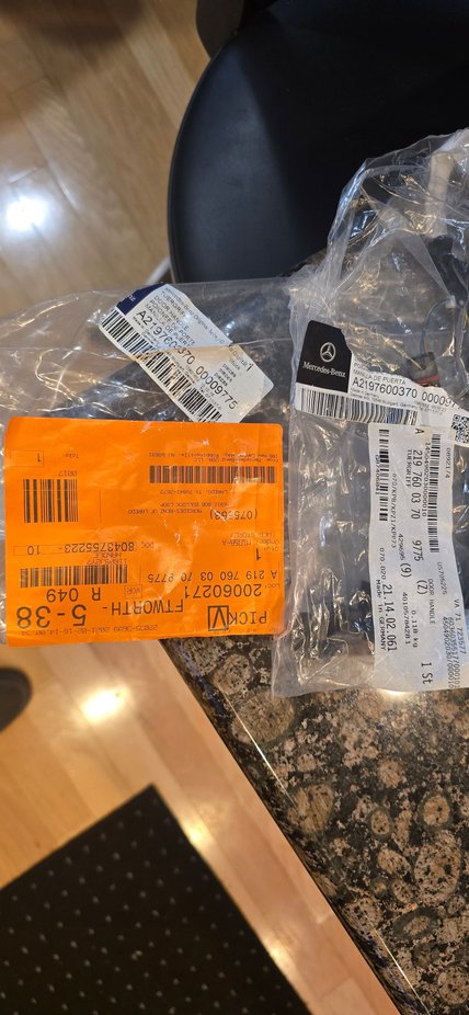

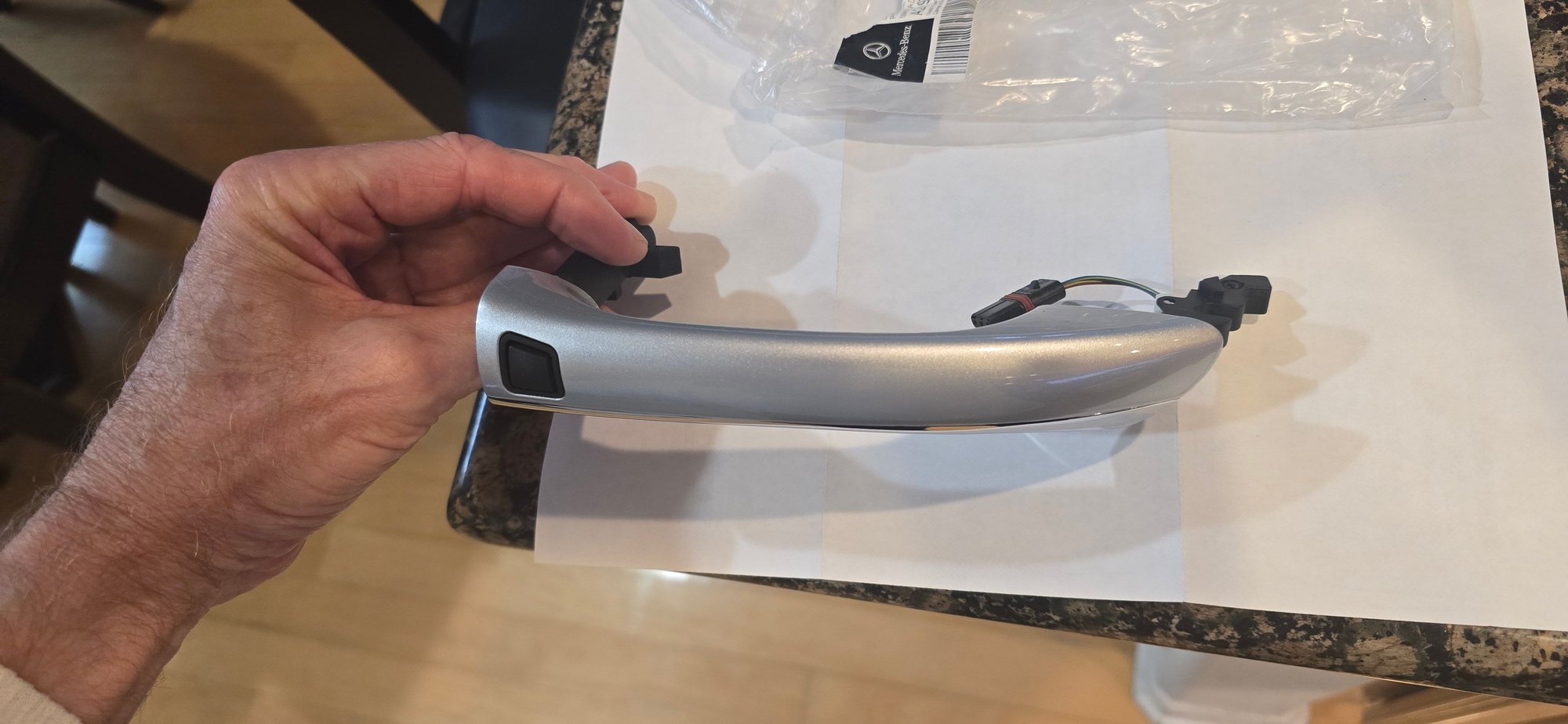

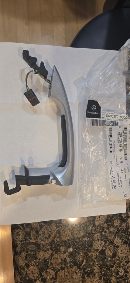

Smile NEW Silver CLS55 Keyless Go Exterior Door Handle 4 Sale
I have an extra BRAND NEW "DISCONTINUED" Iridium Silver, Keyless, Rear, Exterior, Driver-side Door Handle (A219 760 03 70 9775 -aka- A21976003709775) for my 2006 CLS55 W219 that fits several other years & models of the CLS (partial list below?). Here's one Mercedes parts website (https://classicparts.mbusa.com/oem-p...21976003709775) I got this info below. Pics are of the item I'm selling. It CAN BE SIMPLY PAINTED to MATCH YOUR CAR!! I have installed another door handle at this location and it IS NOT hard. Just need a long screwdriver.
  • SKU:219-760-03-70-9775
  • Positions:Left Rear
  • Other Names:Handle
  • Description: With keyless, iridium slvr.
  • Condition:New
Vehicle Fitment
2011 Mercedes-Benz CLS 550 Base 5.5L V8
2011 Mercedes-Benz CLS 63 AMG® Base 6.3L V8
2010 Mercedes-Benz CLS 550 Base 5.5L V8
2010 Mercedes-Benz CLS 63 AMG® Base 6.3L V8
2009 Mercedes-Benz CLS 550 Base 5.5L V8
2009 Mercedes-Benz CLS 63 AMG® Base 6.3L V8
2008 Mercedes-Benz CLS 550 Base 5.5L V8
2008 Mercedes-Benz CLS 63 AMG® Base 6.3L V8
2007 Mercedes-Benz CLS 550 Base 5.5L V8
2007 Mercedes-Benz CLS 63 AMG® Base 6.3L V8
2006 Mercedes-Benz CLS 500 Base 5.0L V8
2006 Mercedes-Benz CLS 55 AMG® Base 5.5L V8
