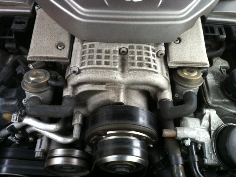

check the pic, these r the valves that need a check u say???
yes if you say your SAIP is working then the next thing to check would be those valves. surge tanks have to come off the remove them.
