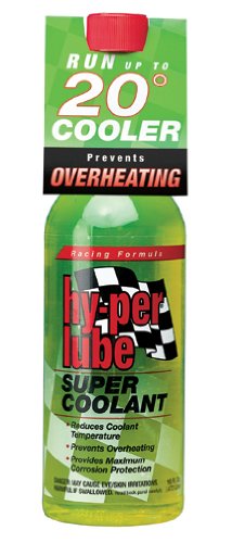

I use this stuff - $8 bottle
Hy-Per Lube Super Coolant - 16 oz.

^ I would look on the label of any product to make sure, but I believe all of the water wetter products like royal purple have corrosion inhibitors in them also. The product toadster listed shows "corrosion protection" on the front of the label.
so it would be okay to run purified water + water wetter only. Of course you have no freeze protection with that set up which is no big deal depending upon where you live.
The old dish soap trick can work, but I would not try it. The stuff in water wetter that breaks the surface tension of the water is surfactant. It is an ingredient in dish soap. Surfactant packages often have foaming agents which are great for cleaning dishes, but not so good for maximizing water contact with the surface of a cooling system. I suspect there is an optimum amount of dish soap to put into a cooling system to break surface tension without foaming, but I don't know what it is. The water wetter products do.
A final note. As I understand it, surfactants are all pretty much the same from product to product. I suspect a product like toadster used is every bit as effective as Royal Purple. That said, I still run Royal Purple.
