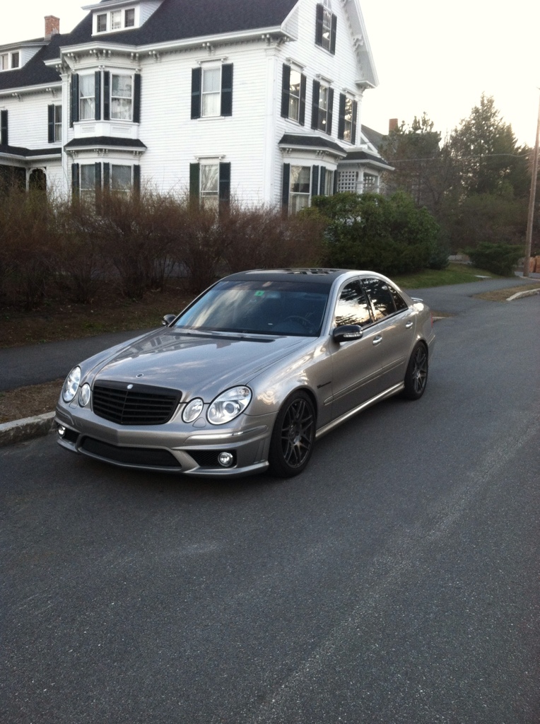

How did you attach the chrome corner impact strips? Also how about the fogs?
Old Apr 6, 2012 | 11:35 PM
  #217
BrianS's Avatar
Joined: Apr 2007
Posts: 256
From: Maryland
2004 E55 AMG
The corner strips just snap right in. Press slowly and work your way around. You need to get the clips to slide on over the holes and screws to hold the fogs in.

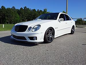

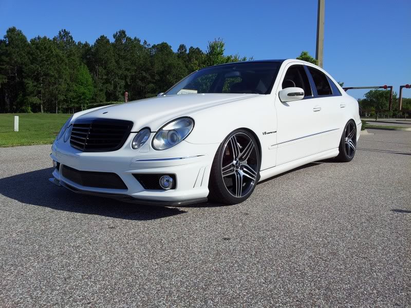

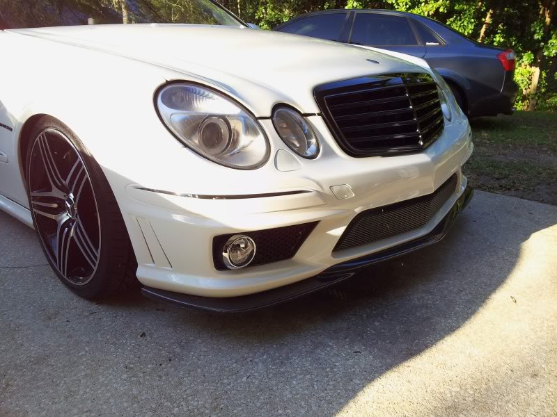

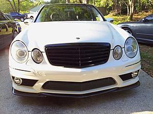

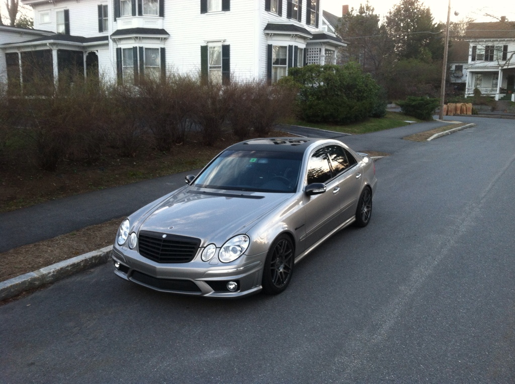

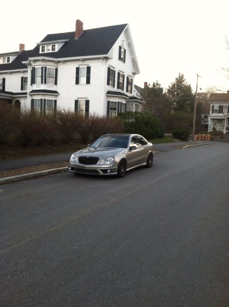

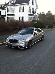

Ok, I played hell getting this bumper on, but finally got it done. I at first couldn't figure out why it wouldn't go all the way on. I trimmed the foam pieces some more and tried fitting again but still no go. I then got under the car and realixed the two connection points in the center of the bumper (the actual oem e63 plastic center piece I ordered that fits inside bumper) was hitting the Eurocharged heat exchanger not letting the bumper go back any farther. These were cut off on the original bumper to allow it to fit, so I simply cut those off all the way flush and then the bumper went on. A little fighting to get it lined up as good as I could and then a few bolts tightened and I was finished. Happy with the end product.
