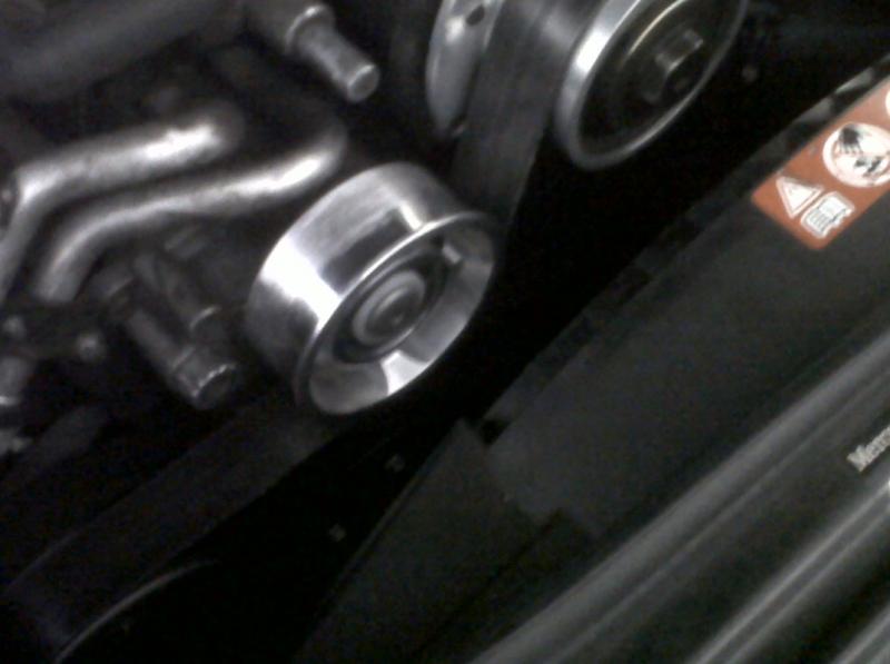

Got tired of belts coming off
Ever since I installed a larger pulley my belt either shredded or came off. I preferred the later but it still sucked. I did not blame the pulley, by appearance it was perfect (EC btw). It just appeared as though the higher RPM and/or torque would cause the belt to wander off the tensioner pulley. To cure the shredding I softened the sharp edge of the pulley with a sanding block and 180 grit. It worked in the respect that when the belt reached the edge it did not get cut while coming off. However, it still came off.
Upon further review I felt I needed a pulley with lips on it so it would not walk. Unfortunately It appears once you add lips it becomes too wide and contacts the tensioner.
So I made my own. Or more correctly modified one already in existence. Basically I purchased a billet pulley and ground the inside lip off. It worked like a charm. The pulley I modified is easily found on EBay. I would attach a picture but I am on an iPad and was not successful.
1986-1993 MUSTANG 5.0 GT BILLET BELT TENSIONER PULLEY

Add Pic
1986-1993 MUSTANG 5.0 GT BILLET BELT TENSIONER PULLEY[/QUOTE]

Nice solution. Some pulleys are well know for losing pulleys, nothing to do with tensioner. The welded pulleys do not appear to have this problem, just the multi piece pulleys.

I am planning on a belt wrap as a permanent solution. But for now it is number 4 on my list.
  1. HE (have larger crank pulley and smaller SC i need to address IAT before summer).
  2. Pump
  3. Headers
  4. Belt Wrap.
I can only sneak one item in the door at once. This was my attempt to be creative. Just to see if it would work.
